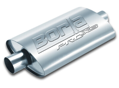

Here are the mufflers I was looking at, a 2.25 a 2.50 and a 3

I ended up finding a NOS HKS stainless steel muffler for $50 Canadian plus $40 shipping, So if its loud so be it at least I know its a quality muffler and hopefully it sounds good, it was the size inlet I was looking for as well as the body size, if I don't like it hey its $90 that's pretty much what they want around here for something oem style, Here is some pics $_59hhbhhbhbhj.jpg
8,165 Posts
Kind of doubt that is a real hks muffler and why are there wire hanging out of it. Looks like a Chinese special to me.
