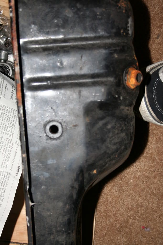

well in preperation knowing i was going to put a 7m into a mkii i purchased a front sump pan, and i also found one with a oil cooler drain.

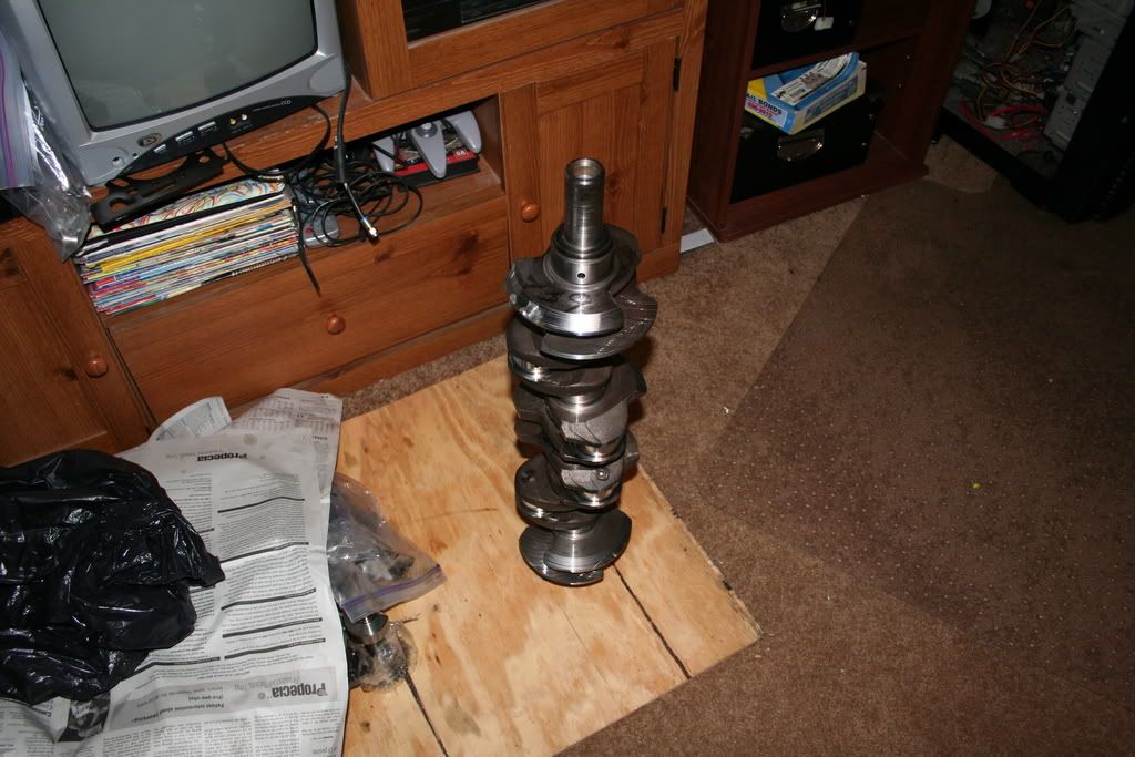

i have had the crank balenced, then balenced again by another shop. unfortunitly it made noise that may not have been bottom end noise and i pulled it apart again, swaped to manual and put new slugs in her and also balenced the crank again, i also had the crank knife edged and i was able to remove 1.5lbs with a single edge cut, and a radius smoothed and tightend.
knife egde pictures.
picture of the radius :
now of course with this much attention to the crank, i wasn't done with the bottom end yet,
i had the crank clean and the passages cleaned aswell, and to keep this free spinning sob to the block im keeping it in check with arp main studs

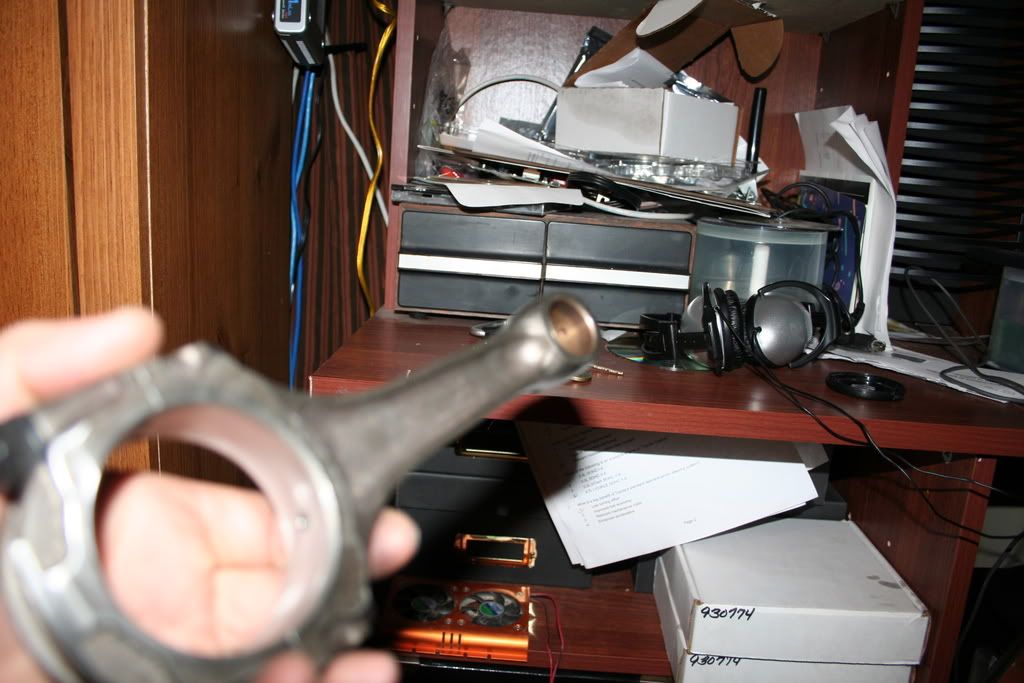

as far as rod's go i couldn't leave them alone either.
picture before the crank was knife edged and above work was done but show's arp's off nicely
i hammered in some arp rod bolts and ended up knockin out a bearing in 600 miles so i had the rod's re-sized and checked for cleanece on both sides and wasn't happy till my machiniest was. but still wasn't done. i had him balence this 3 times along with the crank each time, and the third time i also had him de-stress the rod's and polish them too.
Group pic's :
side of one of my rods
another angle
an attempt to show off the arp rod bolts but instead i got a nice picture of a back ground rod.
ok ok ok , just a few more of the rod's

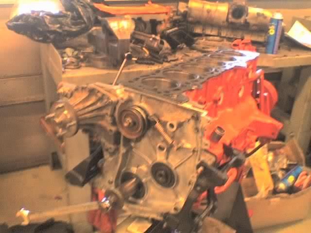

(sorry for the camera phone pic's) some block pics too
almost finished assembling

i thought that all oil pans had the oil cooler return spot. all cressy ones i have have the oil coler return thread. oh and it is a 12mmx1.5 i think.
also i thin kthe pump is for a mk3 not a front sump.
yeah the pump is a mkiii one, it didn't come close to fittin in the pan.
and i was waiting for my crose over tube to arive to put my new pump into it and seal up the oil pan.
thanks for the info on the threads. i knew it was the same as the mkiii turbo so i knew what union to use and bolt.
i thought only 85 and newer pans had this oil return on the pan?

Just a little tip, if your trying to take pics of small stuff close up, use the macro setting. How much did the knife edging and balancing of your crank cost?
didn't see that settin on the camera.... , most of those photo's are taken with a camera phone, the better looking half are taking with a 3mp camera.
any ways, he didn't have a set price for lightening the crank he told me he would charge me by hour it was on the lathe and iirc, it was roughly on the leth for 2 hours and cost almost 200 bucks (prolly closer to 165 or so) i also had the rod's worked over i'll look for the recipt for the machine work to pin done what it all cost me.

What machine shop did you use for your work?
dan hall's of killingsworth in ne portland
im happy so far with the work he took a 1.5 off my crank and said i could probaly take a total of 3.5-4 pounds off the 6m crank.
im going to have him try it and i'll get back to you guys..
