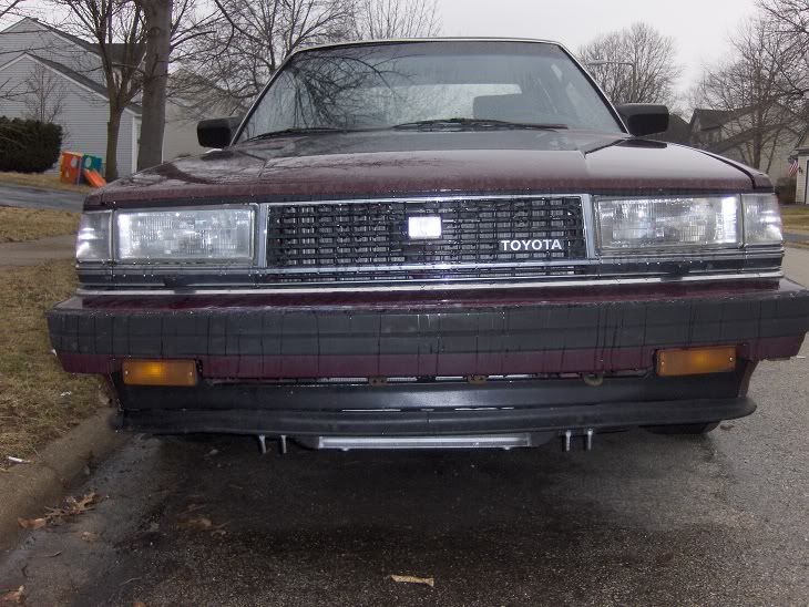

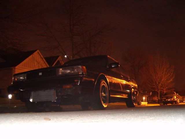

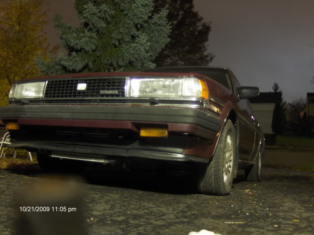

here's my megasquirt setup on my 86 cressida
Factory 5 Speed
Factory 3.73 lsd
Factory Tems suspension
Megasquirt II v3.57 2.890
edis 6 ignition 36-1 wheel with accel coilpacks distributorless ignition
arp head studs,
hks metal head gasket
innovate wideband
440cc injectors
here's how she sounds as of right now, still in process of tuning
