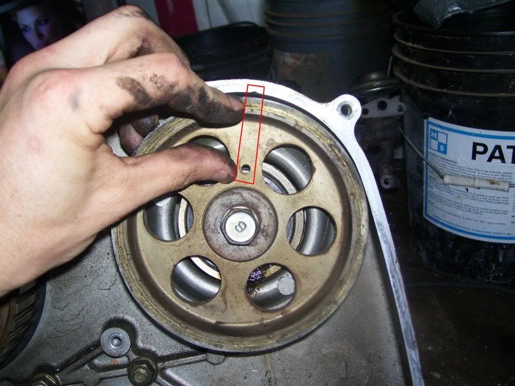

ok i got the first cylinder to tdc by spinning the power steering belt (because it rotates the whole engine ) when it got to tdc i took the timing belt of and matched the hash marks on the gear to the ones on the case ....
How did you make sure it was at TDC? Did you line the mark on the crank pulley with the "0" on the front timing cover behind the crank pulley?

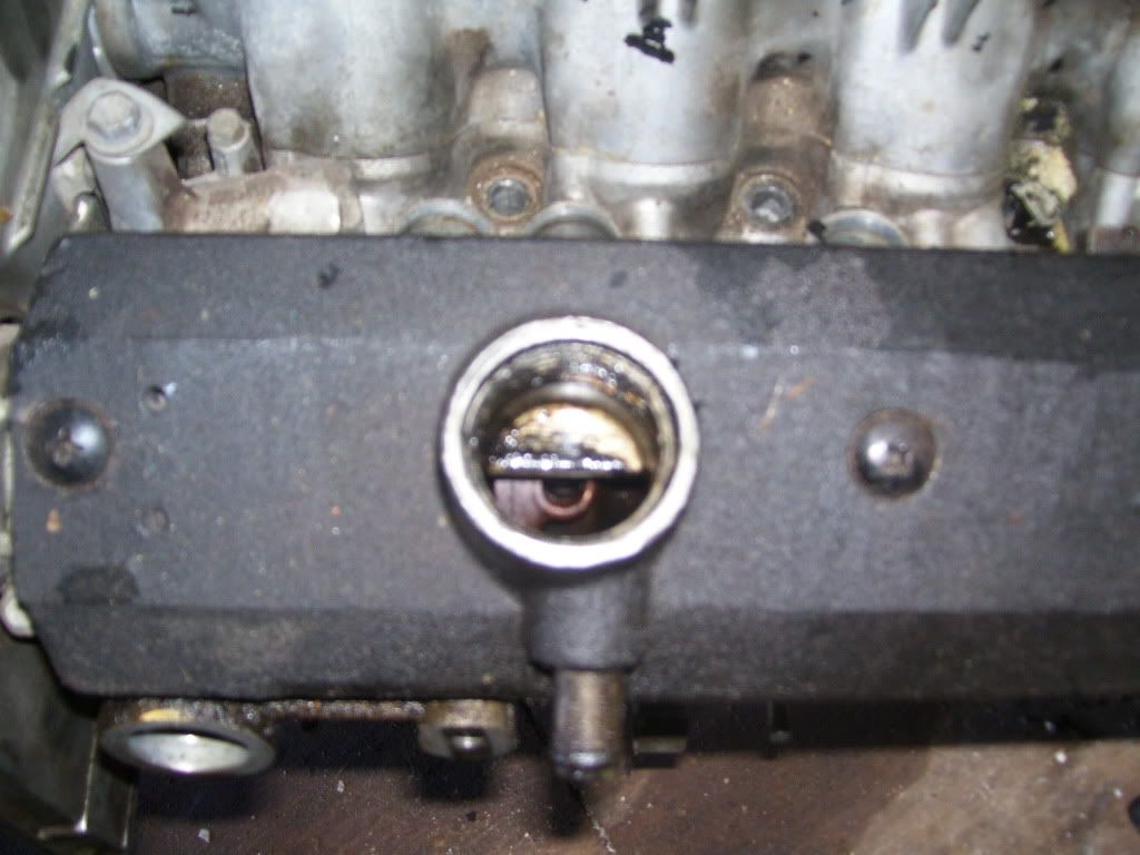

You do know there are 2 marks on each of the cam gears right? Did you make sure that at least the intake cam was correct by taking off the oil fill cap and looking down and seeing if the hole in the cam lined up with the hole in the cam tower? Did you make sure that the exhaust cam gear was also not upside down? If so, how?

Yeah, those are cam gears, what are you trying to show? Well besides the fact that unless if you have messed with it again, your timing is really far off between the two cam gears, and REALLY damn far off if the crank pulley is at TDC. And the belt past the exhaust cam is really loose, you need to re-adjust the tensioner after you re-align the cam gears.
And unless if you did it, someone else swapped out at least the belt and cam gears with the 84+ ones since the 82-83 have a square toothed belt and cam gears that look like the ones that Cody posted.

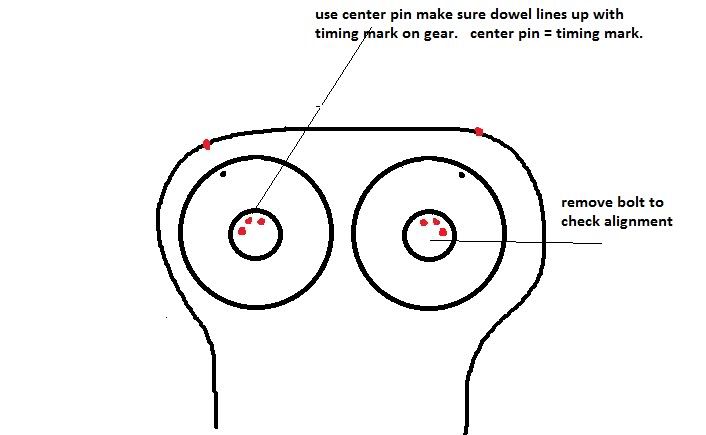

ok i think i know the problem, first, don't go by timing marks on the gear outside. take the gear off the cam and make sure the center dowel is facing up when the dot is facing up on the cam gear. it sounds like your not getting compression, i think one of the cams is 180degrees off, had this problem on a friends car once, it almost sounds like your cranking it without spark plugs. we found that the timing gear was on backwards and,
