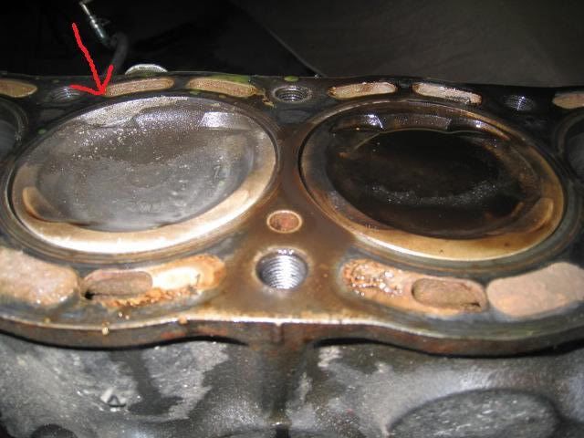

First off, I dropped Compression on Cylinder 3. I'll post up my Compression tests today or tomorrow and let you see the progression of the decompression (on snap, that rhymed).

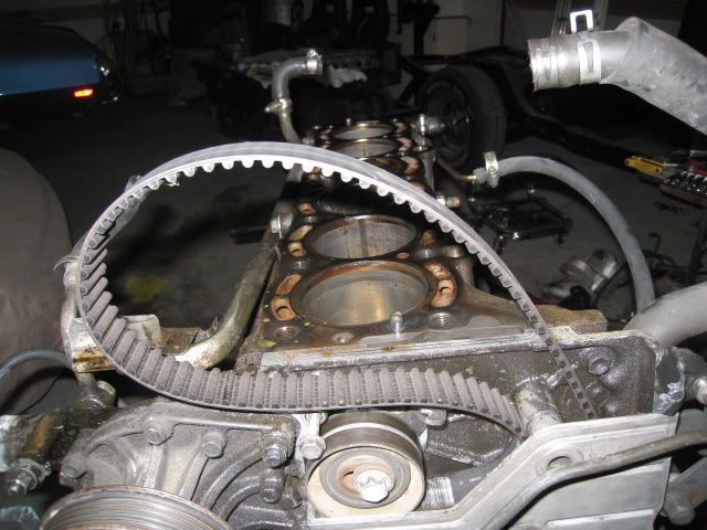

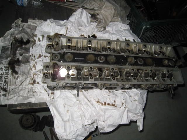

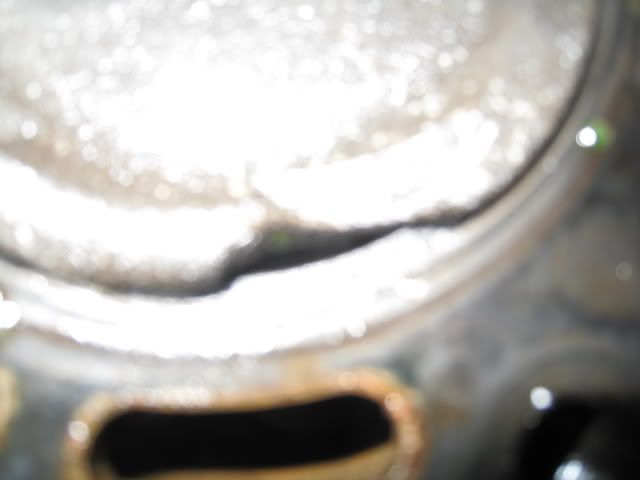

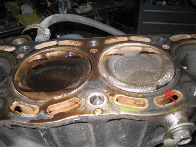

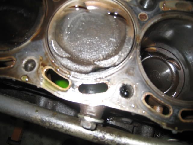

I pulled the engine, it was misfiring and smoking a white'ish blue. I then pulled everything apart and I got the head off today.

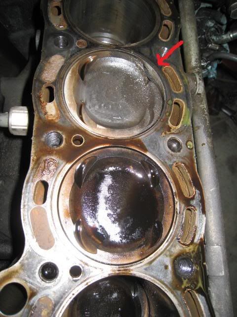

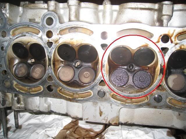

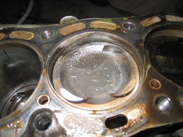

This is what I found, I think I deserve a swift kick to the head :duh:

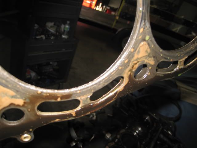

Yeah... so I was looking for some advice. I went to my machine shop and got some choices. We discussed doing (some of the stuff just for safe measure, I don't have rod knock) rings, bearings, 1 new pistons, gaskets, head gasket, head studs (somehow we bent mine?? AND they were ARP!), micro-polish the crank, boil the block, hone cylinder 3, reboil the block (I don't know all the lingo, so if I said something that sounds outa place, then it is out of place!) He said something around $400, I can't remember the exact number so give or take $50. They'll do the machining and we'll be putting it all together (between my brother, my dad, and I we've got it under control. I'm not great with engine work). The guy at the machine shop told me to test the head by pouring gas in the intake and exhaust ports with the valves closed to see if the seals are ruined or the valves are bent (i'll do this soon).

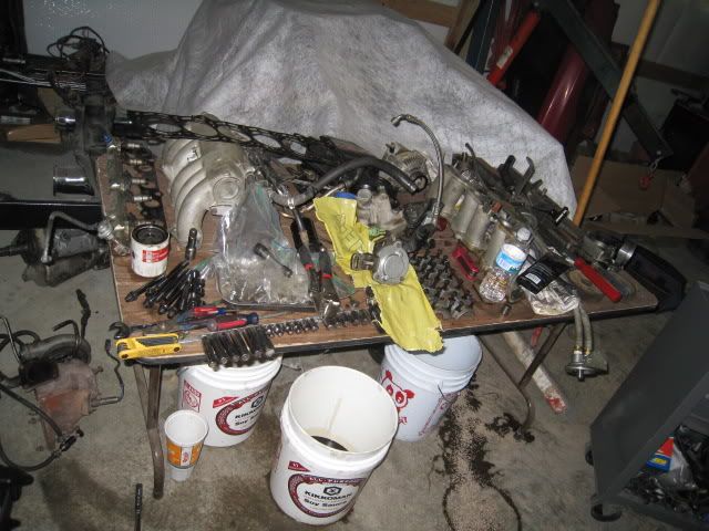

How can you see that? Haha. Do you like my Soy Sauce buckets? Did you see those too, lol. (I'm not asain, btw)

We've come to the conclusion that I leaned out on cylinder 3. The tune according to the Wideband was fine, but I've been told you can't see if one cylinder is leaning out.

you either leaned it out or you had Detonation which will cause the same thing. Either way It doesnt look like you did any damage to anything other than the Piston Itself. I would replace the 1 piston and retorque the Head bolts. If there isnt anything wrong with the Bottom end why spend money screwing with it. If its not Broke, Dont try and Fix It.

I would skip all the extra bottom end work. Get the injectors flow tested or upgrade to 550's. If there's THAT much of the piston missing you had a seriously lean condition on that cylinder. That means that potentiallya clogged injector. I've not dealt with a lot of issues with burnt pistons and the like so take that with a grain of salt.
Also that IS correct about not being able to monitor the Wideband AFR's of independant cylinders. That would require a wideband O2 sensor for EACH cylinder (for a total of 6.). Which would be epensive and take some fancy (and by fancy I mean expensive) gauges to monitor.
