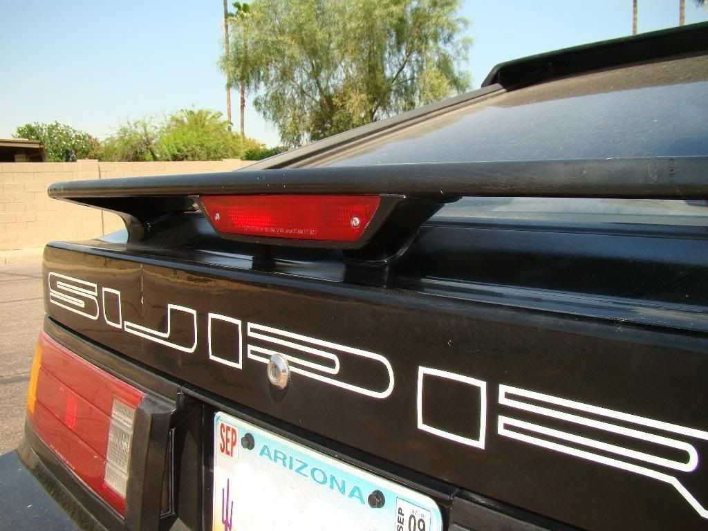

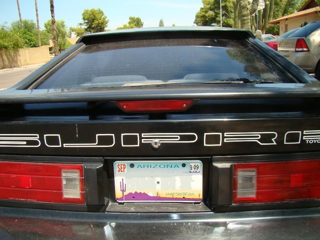

Our '86 MK2 has the factory 3rd brake light, but due to age and various other factors, the housing had melted a bit and because of that, the 3rd brake light hasn't worked in several years.
Here's the original '86 Supra 3rd brake light...
I was trying to decide which route to go to replace it, and I finally settled on installing the 3rd brake light from the '88 Supra turbo's wing! I wanted to keep it all Supra! ;)

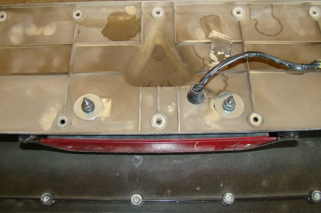

Wiring it up was very easy. I mostly used the original wiring from the '86 light, but had to extand it just a tad. It's all plug-n-play now, baby!!! The pictures should show/give you an idea of how simple it was to install the light on the wing. I did have to drill new holes for the mounting bolts, but that was easy cheesy!
This shows how the wiring for the original '86 light runs through the spoiler and down into the hatch. There is an extra hole drilled through the wing and the hatch on the lower passenger side.

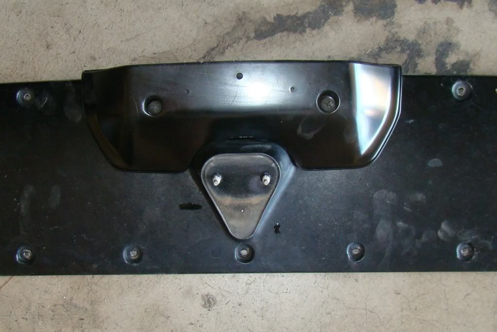

Here I've got the new '88 light mounted to the bottom side of the '86 wing. I had to drill new mounting holes for the bolts, and I used some extra hardware to help make sure it was going to be stable.
Here's the bottom side of the light mounted on the wing...
Another shot of the '88 light mounted. (I haven't yet put the bottom side of the wing back onto the main piece.)
And now the money shots showing the '88 turbo 3rd brake light fully installed on the '86 wing...
Hope you enjoyed this!! I know I'm very excited to finally have this working once again!
Let me know if you have any questions!

BTW, here's a shot of the new light I installed lit up at night...

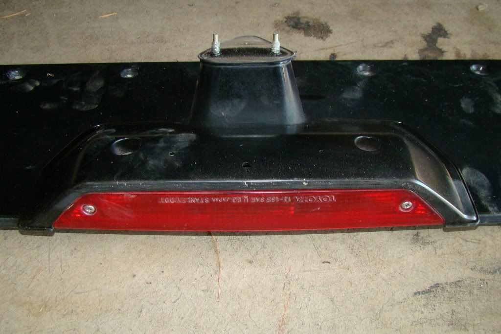

Before pics of the '88T light
Here is a shot showing the difference between the '87T light (top) and the '88T light (bottom)
Here are some shots of the '88 light before I painted it...
I'm thinking that some kind of bracket had to be made to get the light to stick to the underside of the top wing on Tanya's old car. Looking at these photos, it doesn't seem like there's much they could've used to help the double-sided tape stick to the top of the light.
