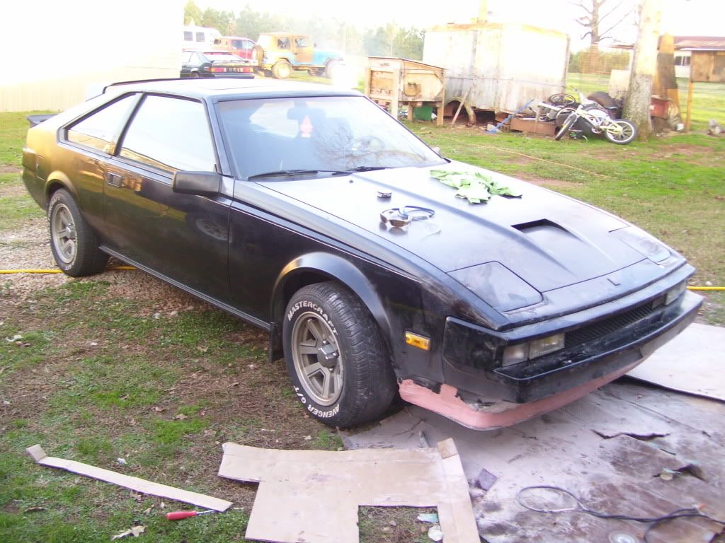

Finally got a little money to buy myself the supplies to finish the job. I decided to remove my side trim before paint. It was hanging off, and I had actually gorilla glued one end of the front piece to the fender, in a feeble attempt to dance around the fact that I either had to replace it, or lose it. I went out and got A tub of bondo, 3 packs of sand paper, a can or self etching primer, and a can of black paint. It matches no where close, but it hides the ugly primer ok. It took me a entire day to tack weld the holes without warping the metal. I finally got it figured out. I had one hole warp up front, but I went in from the backside, and tapped it out.
Bad half way done pic, this was last night, about 6:00pm. Only picture I got, sorry. :(

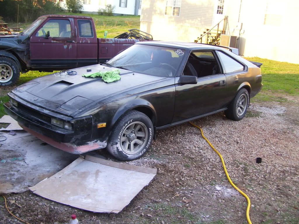

Today I woke up, and decided to finish the sanding, and priming. I got it finished early this morning. I had to go put a new door on my girlfriends grandmas house today thanks to thieves, so I started working on the front of my car this afternoon. I decided to french my cressida lip, and I'm glad I did. I love the way it looks so far. Here are some progress pics. I'll get more tomorrow after I paint it black.
This is after I put on the Bondo hair, sanded it, and put on normal Bondo to make it more smooth. I'm not too worried about the Bondo cracking. That Bondo hair is some really tough stuff.
Annnnd, primer.
Better pictures tomorrow! :)

I would have recomended the bondo fiberglass jelly as its a bit more flexible...but looks good and post up finish pictures.
It looks great already, I can't wait to see what it looks like after I paint it. I found a few spots I need to add to, so I should be finished in another hour max.
cress lip looks good molded. im also a big fan of shaved side moldings. however, i really hope that the bondo doesnt crack on that front bumper, but it probably will. bondo doesnt flex well.

fiberglass jelly, then take some of the bonder fiberglass woven fabric and shred it all up and mix it in so its still like paste style with the strips, then its flexible and strong.
That's exactly what the Bondo hair stuff I put on it is. Regular Bondo with fiberglass shreds in it.
That's my plan if this doesn't hold as good as I think it will. Atleast I'll have time between now, and the time I'm getting it painted to make sure it will indeed hold up.
