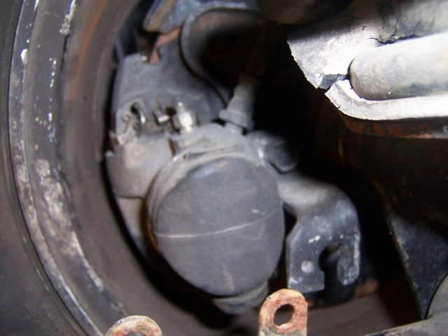

I have a 81 MKI Supra rear axle in a Cressida wagon, but I can't figure out how the e-brake / parking brake cables connect to the rear brakes.
Does anyone have a pic of their rear brakes where the e-brake / parking brake cables connect to the rear brakes?
I think they hook up to this bracket. :confused:
Thanks in advance for your help!!!

It attatches like this (ignore the writing):
There is a flat spring clip which holds the cable housing to that bracket. Then the end of the cable has a pin that slides through the actuating arm which is held with a cotter pin.
This is actually the brake calipers/cables of my AE86, but the cables fit the MK1 brakes - I checked w/my MK1 calipers.

Thanks assassin!
Nice detail and info in the pic.
Now I need to find MKI cables and try to hook them up.
855 Posts
A Lokar Universal Parking Brake Cable kit was installed and it works great.
Thanks again assassin for your help. If you or anyone would like a little write up, let me know.
