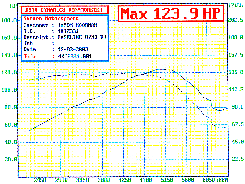

Dyno runs comparing clutch fan to e-fan. The scale changes between the two, and all runs were made in 3rd rather than 4th, but it's usefull for the sake of comparison.

moorman... is it just me, or did your torque take a huge jump with the electric fans?
im usually pretty decent at reading a dyno sheet, but im not sure if that huge jump is correct, or if my eyes decieve me, and also, whats the speed that most cars torque and horsepower lines converge? isnt it usually around 5252 rpm??
Jason
Were the fans running when you dynoed with EF? In real life, when
the cars moving, the EF's would probably be off (especially in the
upper gears). If the fans draw about 20 Amps you're using about
1/2 HP to run them (including inefficiency losses) so you should add
1/2 HP to your EF dyno run.
StanS
Take a closer look at the graphs, I was thrown off at first as well. The scale numbers are different on the 2 charts. In both cases, his peak torque was just over 135.
