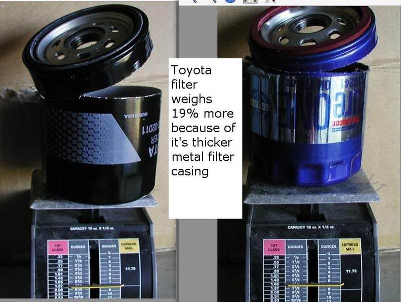

Again, what does Toyota know about filters? I will be at a Toyota dealer tomorrow and will ask about them, maybe I'll buy a couple.
Oh I don't know... Perhaps that they've been around for along time, spent MILLIONS on engine Research and Development, and have a filter that's designed specifically to meet the pressure/viscosity/and filtration requirements of said engines.
From www.tundrasolutions.com
Factory filters can keep a Tacoma engine going for 1,000,000 miles
http://i5.photobucket.com/albums/y189/mastertech/957-1.jpg
Factory filters have a thicker and heavier filter shell
that won't blow off and ruin the engine (Purolator)
Factory filters also have a "O"-ring seal that won't stick to the engine block
and cause a new oil filter to leak oil
Factory filters even have more threads to help hold the filter
more securely to the engine.
But none of this matters to many younger owners because they find the black factory filters unacceptably unexciting and boring. They require a filter to be brightly colored and have cool sounding name like "Pure-One" or "TRD"​
That's enough for me.
The ONLY other filter I would EVER run is the AMSOIL setup... but I'm cheap.
Choose whatever filter you want... I know which one I'M using... :duh:
