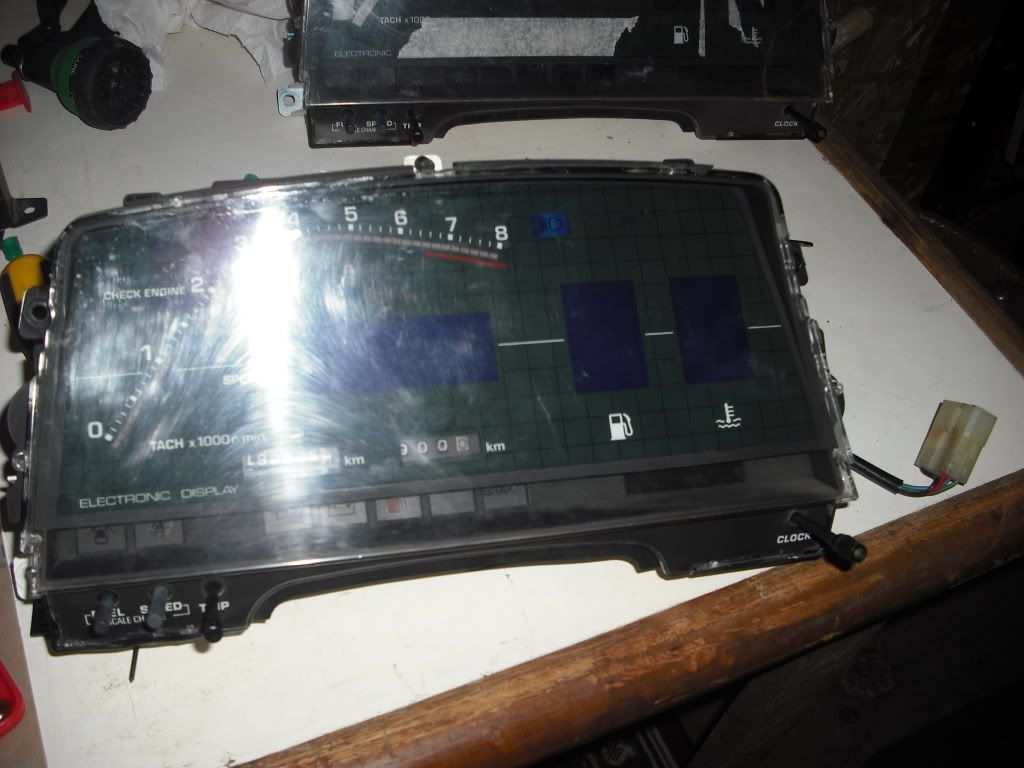

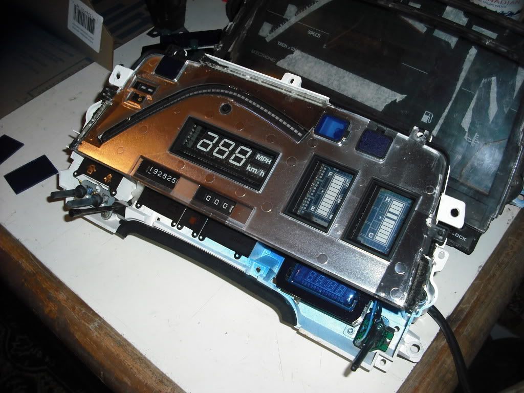

now I can finally show everyone my digital dash gauge color change

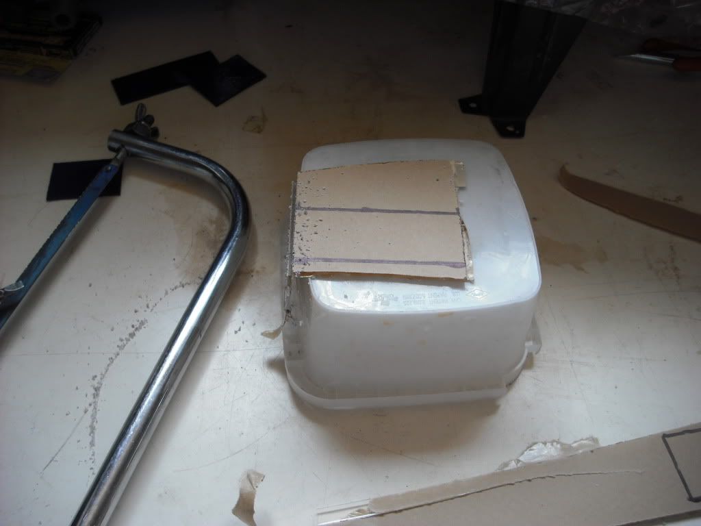

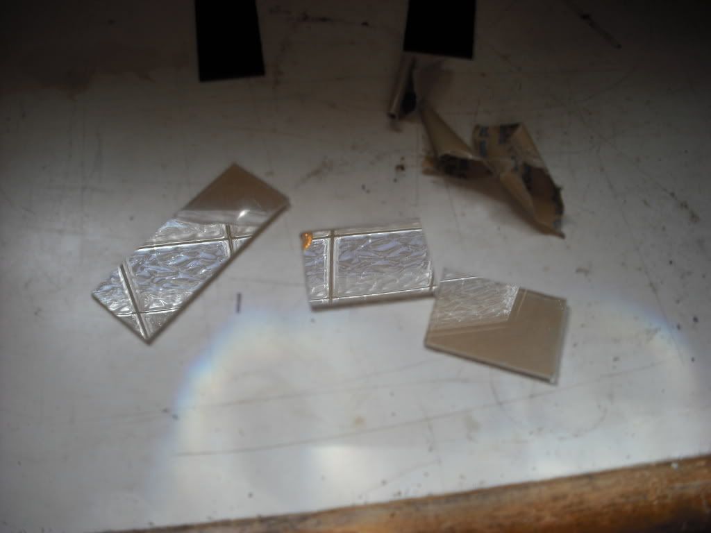

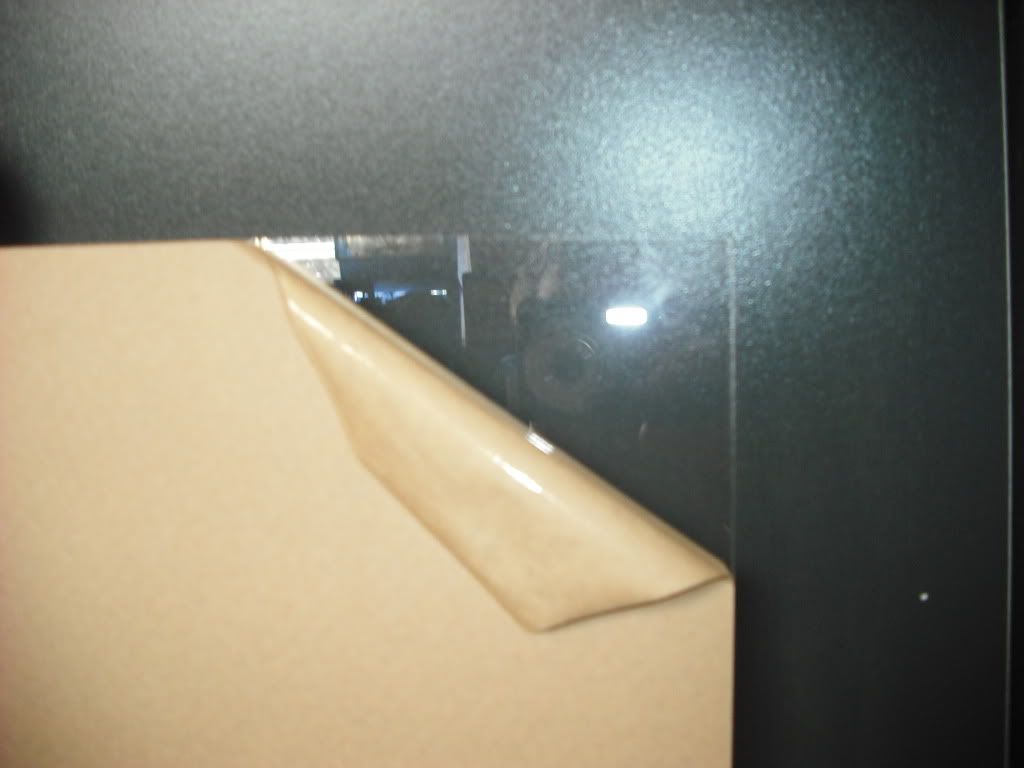

I just got the thinest peice of plexy glass that rona had

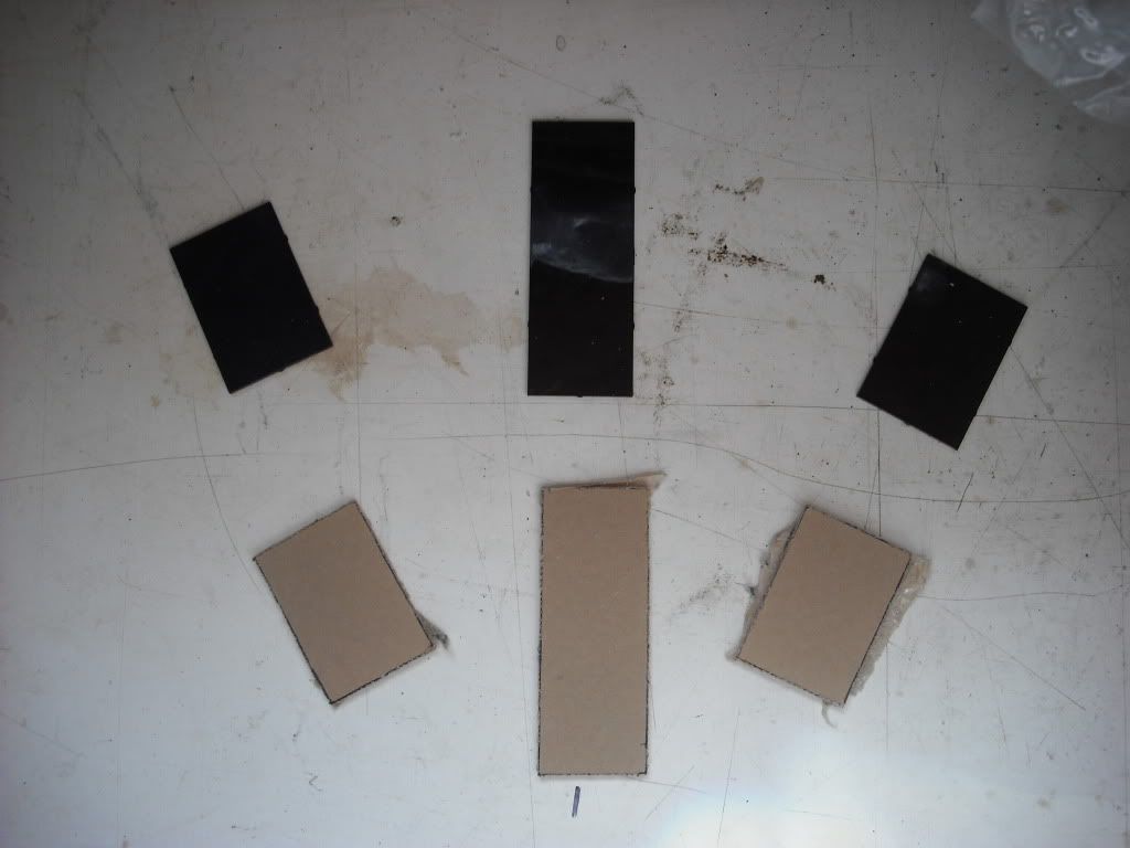

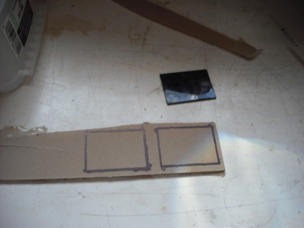

then took out the old lenses and used them as templates
then just used a hack saw and cut them out
then I sand down the lenses to fit lense socket with a pretty mild sand paper then i took off only one side of the paper protector

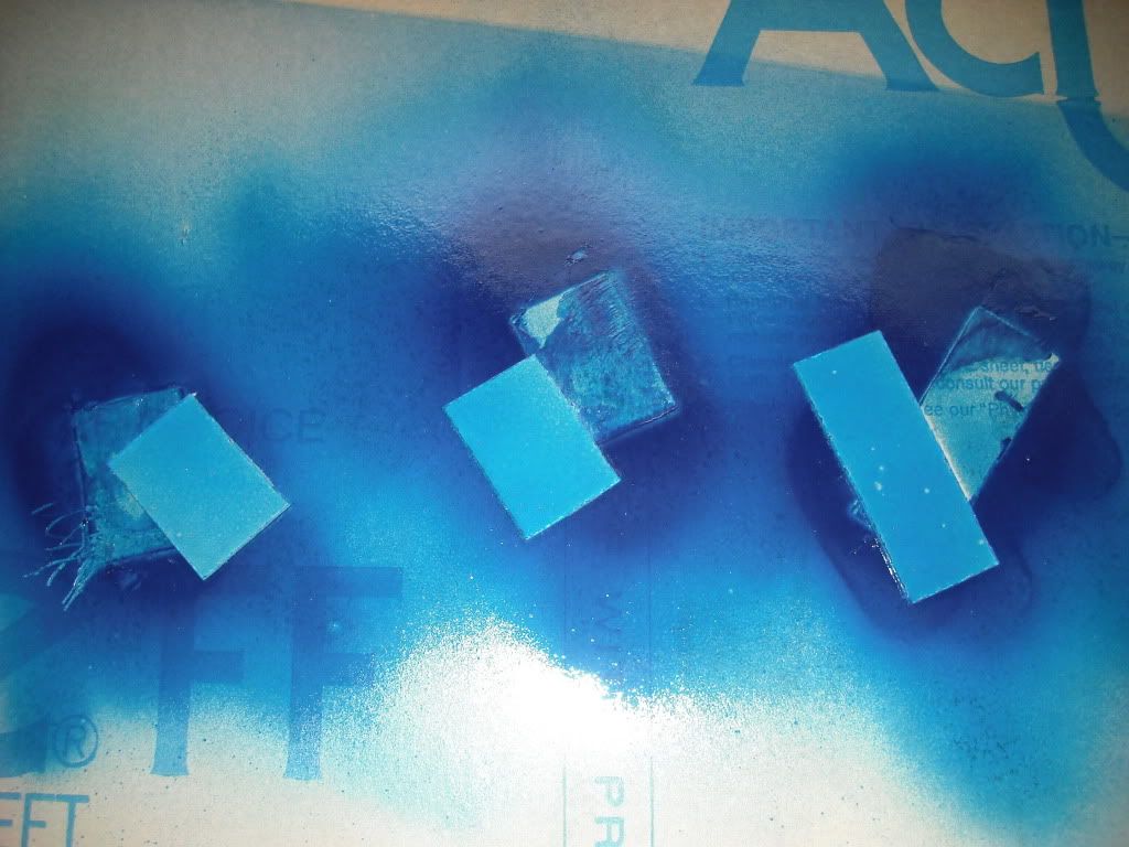

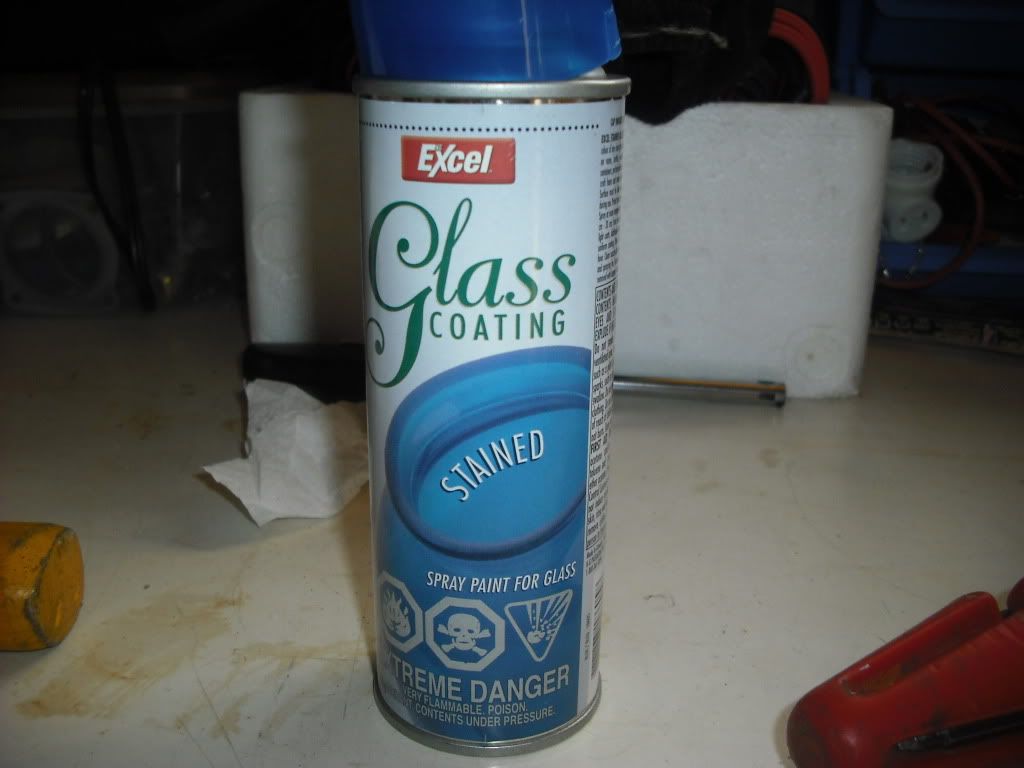

and started painting

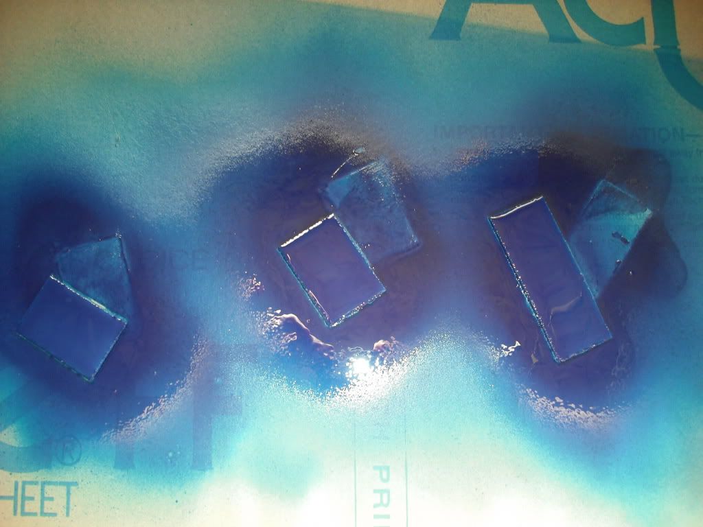

using this glass paint
but you only want to put on light coats at a time and ill get so pics tonight to show you the difference from light coats to heavy coats but you still want the lenses to be fairly dark thow

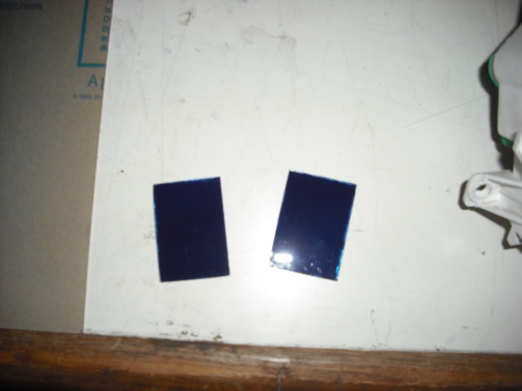

then put them in and done
Like I said ill get pics when it gets dark today

ok here are the night pics and the fuel and temp gauges need to be redone as i got too rammy and put the paint on to thick but I took my time on the speedo lense
