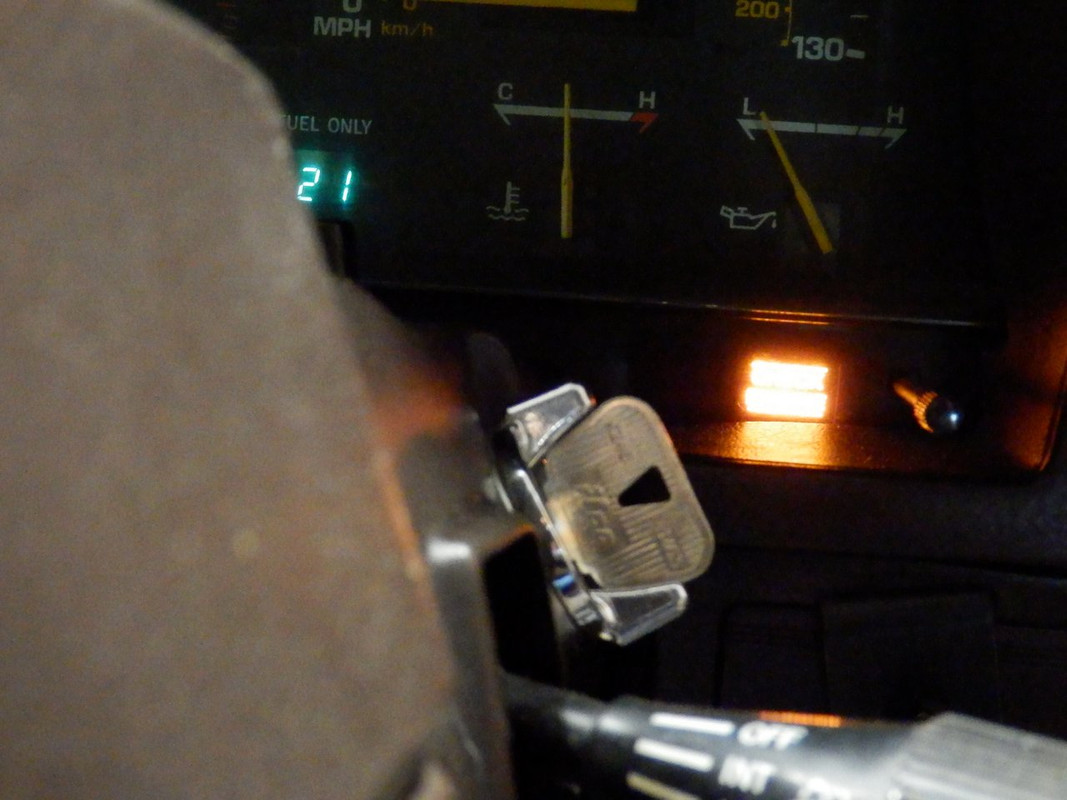

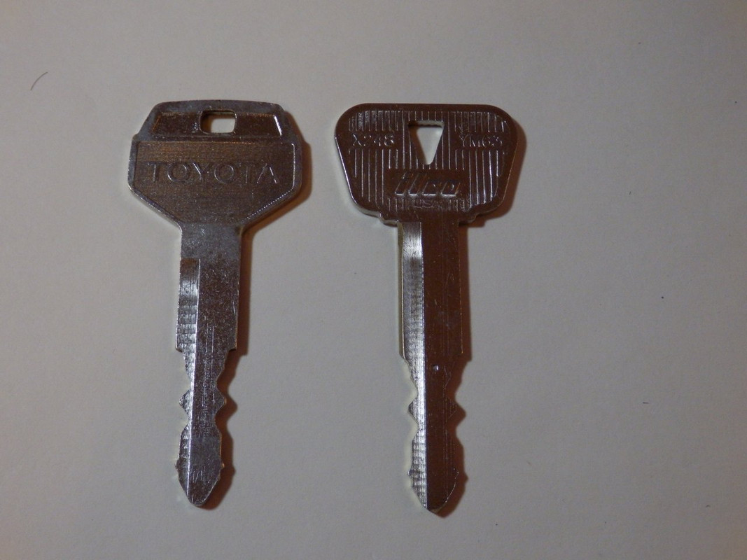

OK, BINGO, another option. I went to another key shop and they were able to modify the Yamaha Style key blank to work. The style key is YM63 or X248. The problem with these keys is that they have a raised fin along the outside of the keyway groove above the shoulder that must be ground away to work in the CS 84-86 ignition. Local key shop ground off those fins and cut the key, and it works fine.
Here is a pic of my Toyota key and the modified X248 key side by side.
Here is a pick of the X248 key in the ignition:

On the Yamaha blank, did you have to cut from shoulder down to get rid of that funky tip?
Yes, The Yamaha blank is a tad too long anyway so when the lock machine makes the bit cuts, it cuts off the extra length too. Your locksmith will know how to make it work.
