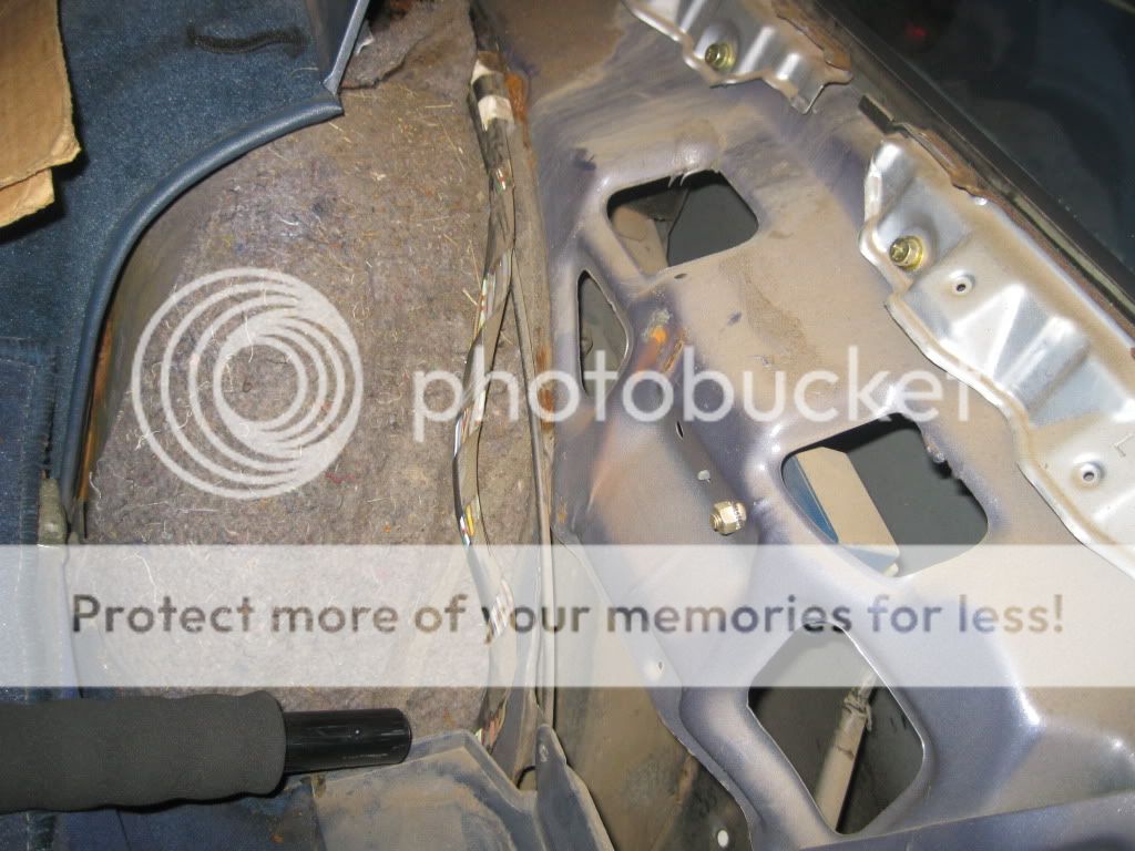

You can see in my first picture where water has run from under the glass (tracks in the dust) and down the sound insulation on the wheel well. I removed the surrounding interior panels and outside trim to fix it. I went all around the window inside and snugged up the window retainer bolts.

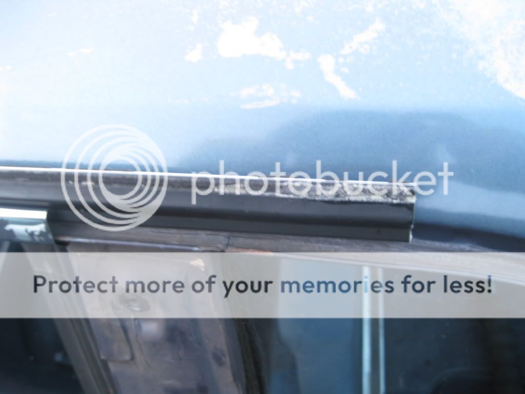

I took all of these pics after I fixed it, when I finally had access to our camera. I was in the process of installing the exterior trim. This pic shows the huge gap between the glass and the metal lip it's supposed to seal against. I filled it with black silicone.
Here is an exterior shot of the whole window. I cut what old sealer I could from around the outside of the window, took a scrub brush and water to clean out the gap of dirt and old sealer, and let it dry overnight. The next day I filled the gap all the way around the window with a tube of black silicone (not the whole tube though). I carefully tooled it so the new silicone seal will be hidden by the trim pieces. So far it's nice and dry in my car, so it worked as a quick fix. Mind you, I had to do this outside in 50* weather, the only chance for this warm of weather before winter.

Nice job! It's nice to know that the dust back there is really a diagnostic tool...

I would've taken the window out myself. The weatherstrip around the window used to be fairly cheap from Toyota.
Yeah, removing the window would be the "correct" way to fix this, but I was quickly running out of time! If I had a garage to work in, with electricity, I would've pulled the glass, bought a new windshield ribbon to stick onto the window, and reinstalled the glass. THEN I would've siliconed it from the outside. You gotta do what you gotta do, ya know? :) I'm just hoping I can get the black Supra's windows done before it rains in a couple days! Eek!
