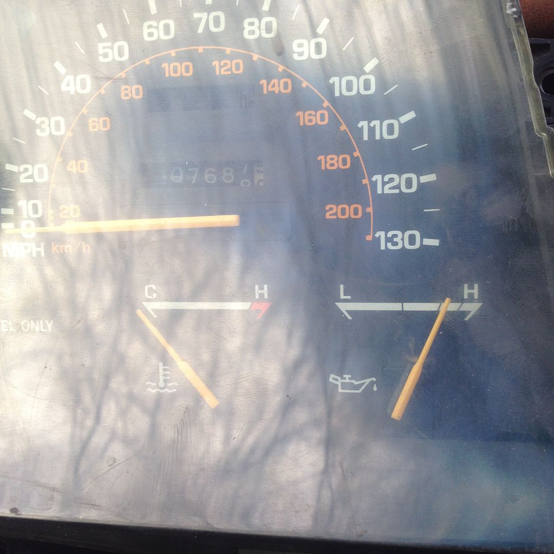

So the drift motion upgraded oil pump does pretty well :) oil pressure gets way up there and once I toss on my oil cooler kit it should do awesome all the time. Once it gets fully warmed up it drops a little but thats going to happen.

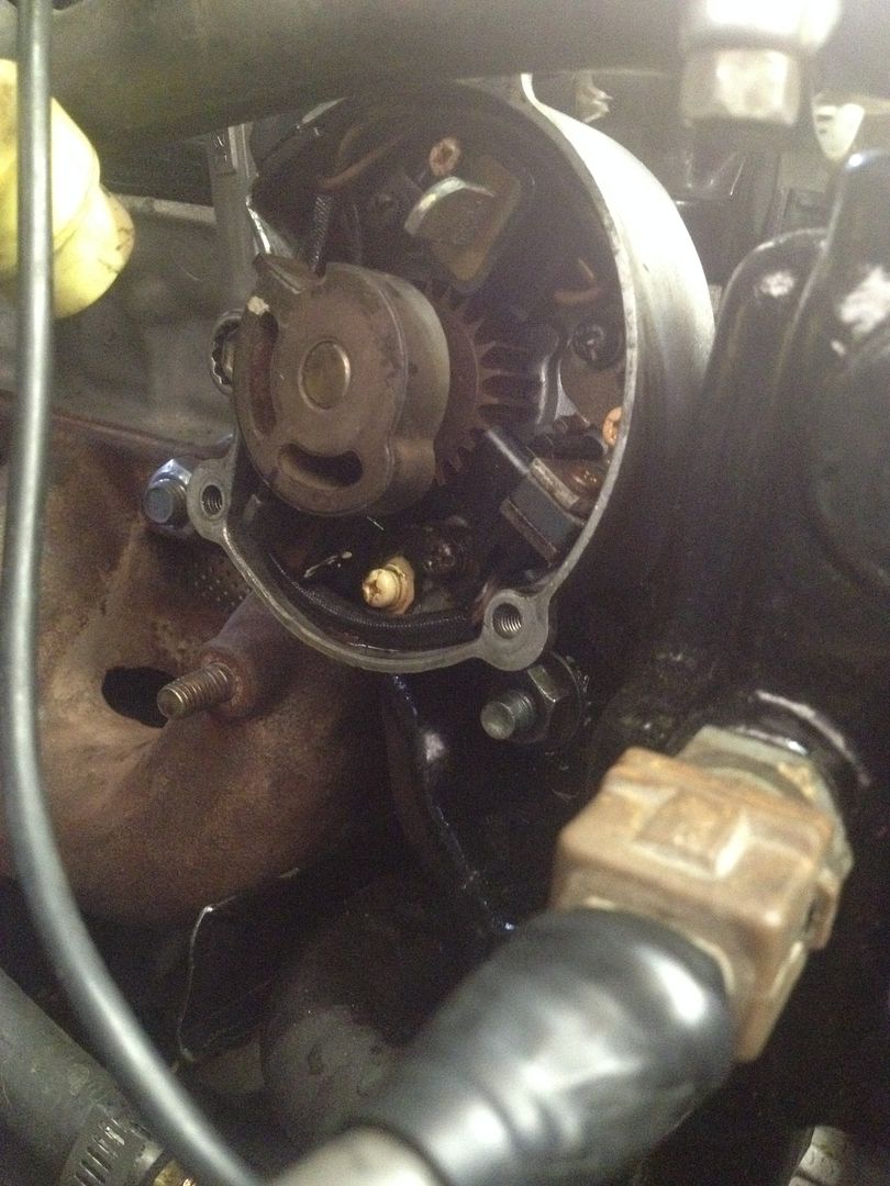

Here you can kinda see the puddle of oil that was at the bottom of my old cas. The wires were also brittle and the wire wrap was pulled off in the plug and was corroded. Didnt even want to mess with it so just got a new one.
