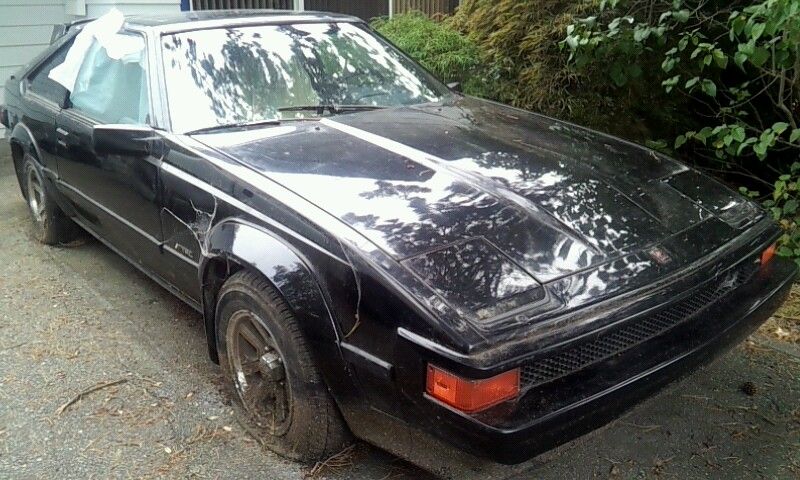

So, we drove to langley and met the owner of this.
The car wasn't in great shape, but even still I thought it looked awesome,
We bought the car, filled up the tires and towed it to my dads shop.
It was really dirty from around two years of sitting...

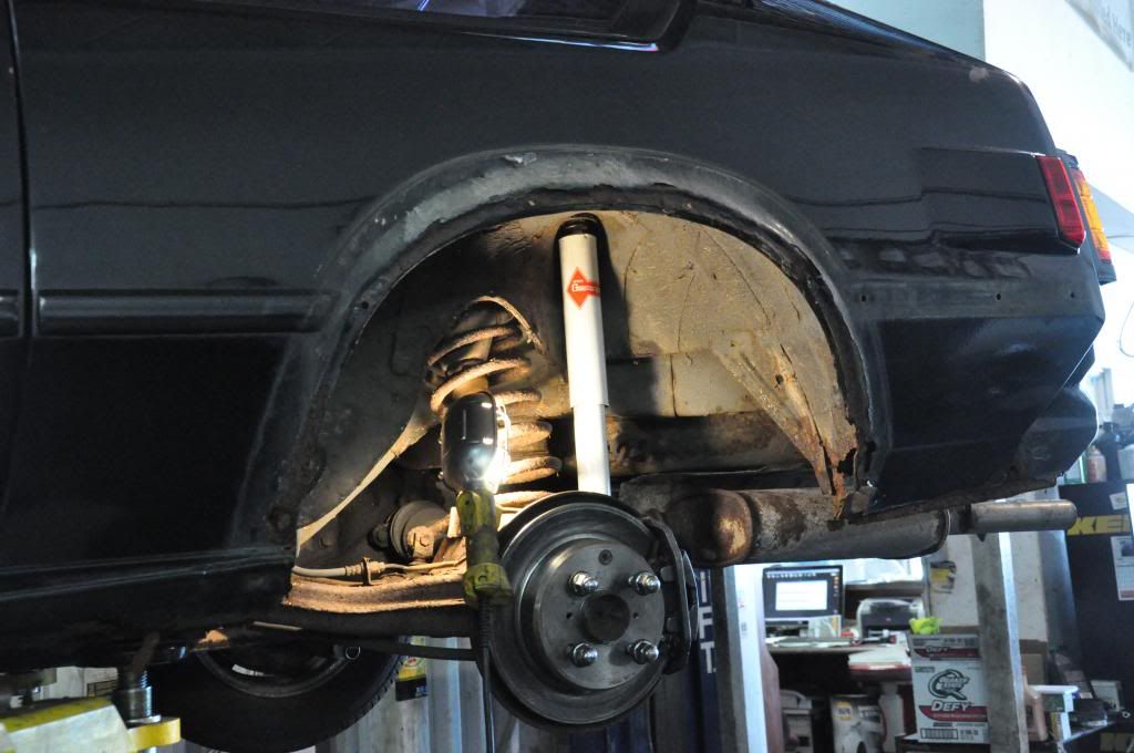

I'll skip to the rust repair part now, since it took from September to June to fricken deal with and I just want to get it out of the way,
To start, we took off the rear flares and bumper.
I don't have pics of the passenger side, but it was pretty much the same as the driver side.
Then cutting and welding and priming.

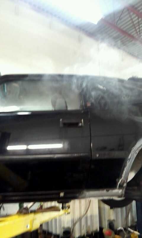

Of course, nothing ever goes perfectly fine.
I took this pic as a joke to send on snapchat saying that "look my car's on fire" because as the body guy welded, smoke would often come out of the windows. After I took it, the smoke wasn't stopping like it usually would. I told the body guy that it was smoking alot, but he was like "don't worry" as he continued to eat. Finally he looked at it, and freaked out. I got to the lift to lower the car, and he grabbed the fire extinguisher. Luckily we saved the car in the end, but it still was damaged.
Alot of the interior in that area was melted, like the seatbelt and panels,
And a bunch of other plastic pieces in there are warped and don't fit right anymore. Some plastic even fused to the seat.

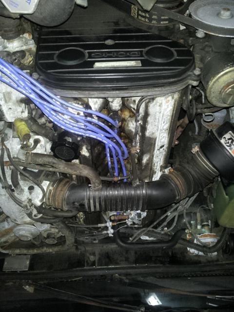

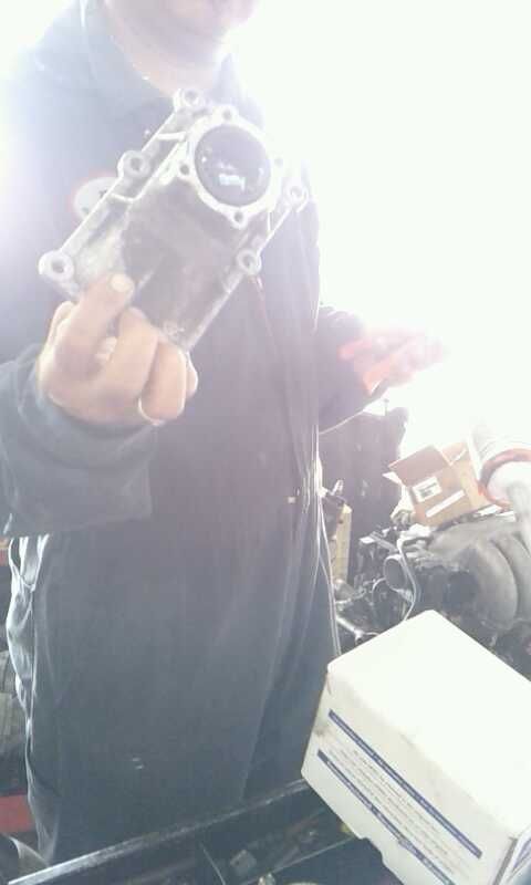

Okay so the whole rust/paint thing is done now. So back to september of last year, the first two weeks of owning the car were mainly spent on ordering and changing the following parts - KYB Gas Adjust Shocks, New(used) rear callipers, wiper blades, and battery. I don't have pictures of that stuff cause my dad did that while I was at school. The car also didn't like to shift so we had to remove this thing
^(not me)
clean it up and put it back in..
After that the car was driveable but the shifter was still really sloppy.
While that part of the transmission was out, I decided it was time to redo these valve covers/things...
So following this video,
https://www.youtube.com/watch?v=-DrexFHQlQ0&feature=kp
I got to work. On my side though, I had access to a solvent cleaner and a shitty sandblaster.
Getting cleaner...
Ready for paint, (It kinda looks like I used primer but I didn't, I went straight to paint)
Starting to paint,
Finished,
Back on the engine,
And an actually nice photo,
Bought the paint from Canadian tire, I think it was duplicolour engine enamel but I'm not sure. It was 5-7 coats on each cover and heating them up for every coat. I used a file and sandpaper to get the paint off the letters which probably wasn't the greatest idea.
I think a better idea that I've seen some people do on here recently is to just wipe off the letters/protrusion for every coat. It saves alot of time and work, and the letters wont look as scratched as mine, though I never used a high grit paper.
Also I didn't know about the wrinkle coat paint back then, probably would've chosen that instead if I knew.
The valve cover gaskets and gromets were also changed upon reinstall.
In anycase, the fresh valve covers made the engine bay look completely different, :)
