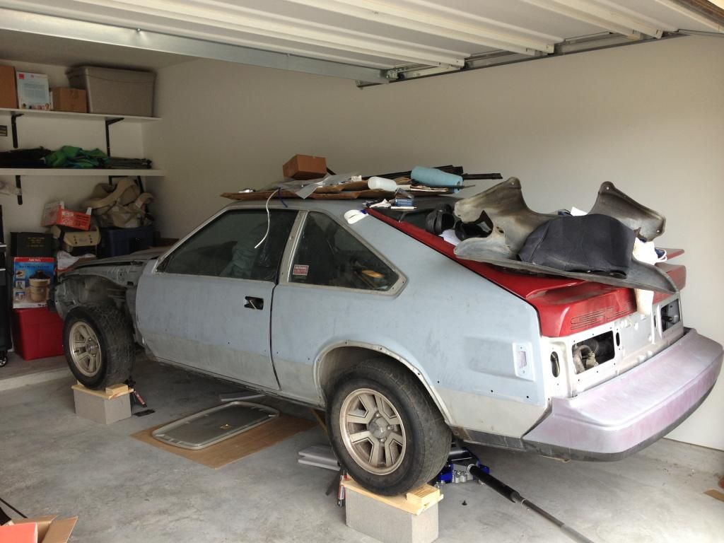

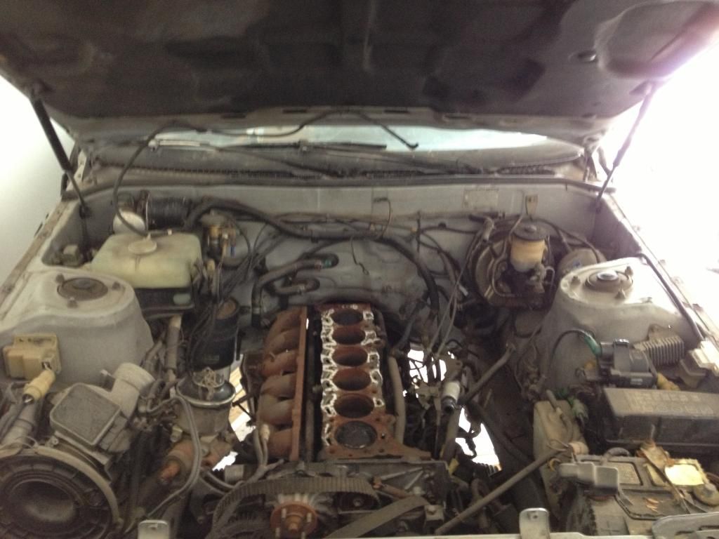

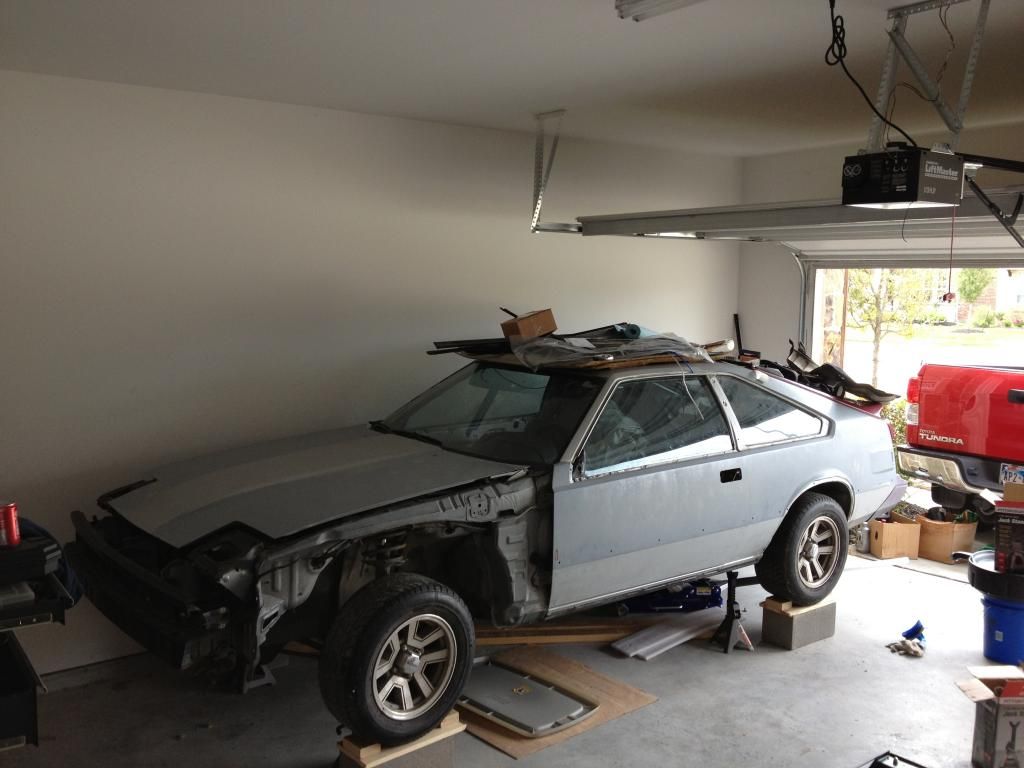

This build will be a little slow. Right now I am acquiring parts. This is my project as of now. I have a plethora of parts from when I bought the car. Three palates as a matter of fact. This car is from California and is in awesome shape. I just got under the car today for the first time and it looks really good underneath.
My first step of the project is to hammer out the tunnel for the R154 install. Pics coming soon.:salute:
