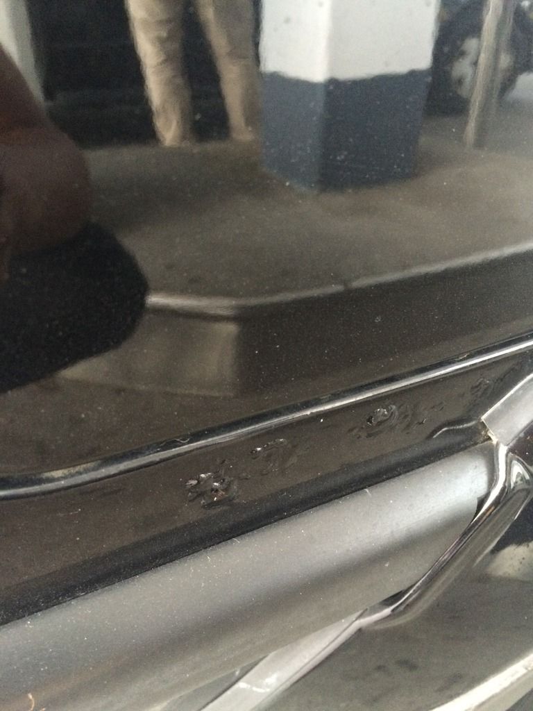

The next section will cover the dreaded issue of rust, I was told by the previous owners that the car has "little to no rust", I was extremly skeptical but took what they said at face value. I basically purchased this car with minimal research in to the common problems of the celica supra. Impulse buys aside, the drivers side front quarter panel (near the rocker panel) was apparently repaired for rust via being patched by a welder. The whole underside has been sprayed with a black rubber/bedliner coating. There is some bubbling under the gas cap door. And most recently, I lifted up the floor mat and found the carpet to be *wet* which was deeply disturbing, as we have had heavy rains for the past 3 days before I found this. It appears that both passenger and driver side carpet floors were wet. I found this out as I was climbing up a mountain road with a group of friends. I want to optimistically chalk it up to condensaition from a hot exhaust that leaks right at the cat. After reading many of "suprafiend's" posts concerning rust issues on seemingly clean cars, I am thinking it is something much worse. Especially after seeing how deep the rust goes on our cars. There is only one exposed spot of rust, it is in the top corner of the engine bay, tucked up against the firewall. The more I read about the potential for rust, the more down I become, but im still happy with my purchase.

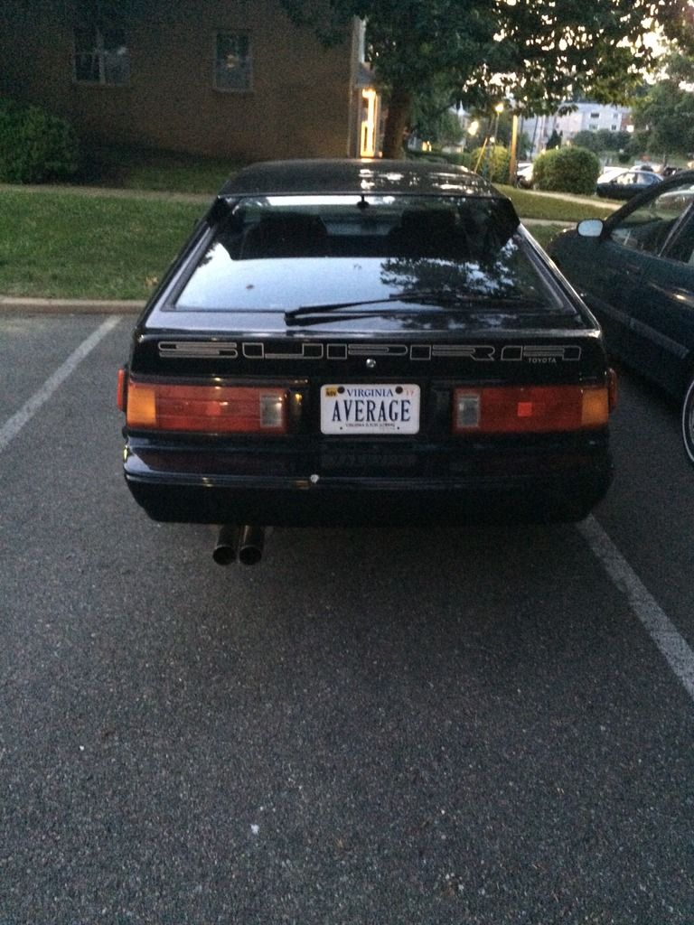

To round things off , the only after market parts that I can visually identify are: the misplaced and misaligned supra sticker on the rear hatch (above the lock cylinder and crooked), and the 2.5inch raptor racing exhaust, with high flow cat.

I am indifferent to the hatch sticker placement now, but it is so irritating to see it slightly crooked and off center, so that will have to be rectified immediately. I am living the broke college student life, so improvements will happen slowly.

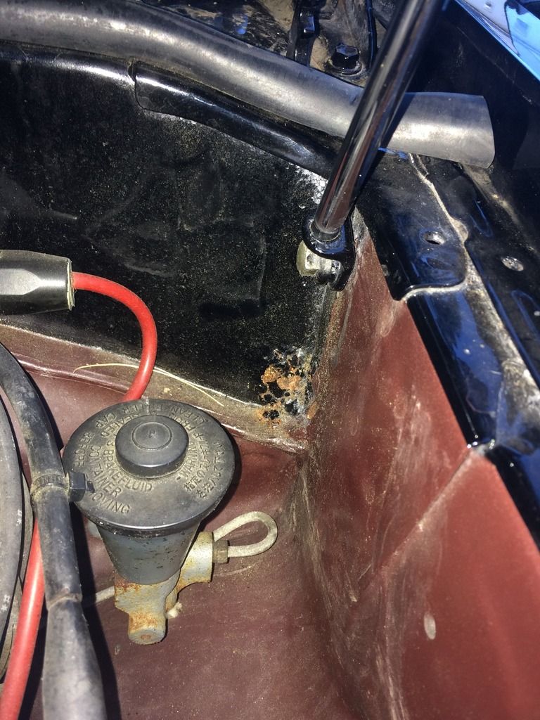

Ok, quick update (no pictures sorry). I have always had a small leak in the clutch fluid reservoir. The kicker is I bought the damn car with it, and I never ever saw brake fluid on the floor under the car, so I ignored it and kept an eye on the clutch fluid level, adding dot 3 brake fluid as needed. After changing out a very dead slave cylinder, I still had a leaking issue, after long drives, I would wake up and see that the fluid level went down by 50%, so to avoid getting air in the system, I would fill it back up.
So yesterday I finally got tired of it all and had a couple friends around after an extended cars and coffee. I also happened to have a spare duralast master cylinder for the car lying around. So we got to tearing the unit out of the car. While I was unbolting the engine bay bolts, a friend was having a go at the firewall bolts (inside the cabin), he ended up finding where the leaked fluid was going to. As you can imagine, the rear seal of the master cylinder was puking brake fluid into the cabin, covering a majority of the firewall. After that small but inconsequential hiccup, we got to installing the duralast master cylinder. Let me go ahead and cut to the chase about this god awful unit. Installing it was a nightmare, at first we bolted the unit on the cabin/firewall side but found out it was nearly impossible to thread one of the bolts. Bottom line, the new master cylinder was too thick, by approximately 5-10mm (that's the extra thickness from both sides added together). It was a supreme PITA, but we finally got the sucker on.
Im sorry about the low quality post, me and my friends finished right as the sun set, and we were all running on less than 3 hours of sleep. After we finished I was too pissed with god-awful debacle to take any pictures. I will try to follow up with a picture post showing where the new duralast unit is too thick, and where you would possibly run into issues.
As a final note, it seems the master cylinder was an oem/original part, it had (aisine) stamped on it. So that was potentially the unit bolted on from the factory in 1983, shame it had to have crapped out.

You are not only one that has had the master cylinder issue you might want to check and see if there was break fluid leaked into the driver side foot well as that was common for the 3 master cylinders that have gone bad on my car. good luck withe the car and fix that rust before it becomes a problem and you might want to check under the back seats if it has that much rush on the exterior.

There is a large amount of fluid leakied into the driver's side foot-well, I really should just strip the interior and see what I am working with in terms of fluid(s) to clean up, and rust to inventory. Also I found some more rust spots, I guess @ suprafiend wasn't lying when he mentioned "most of these cars have rust"
