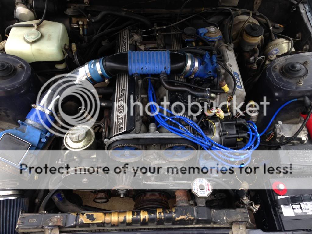

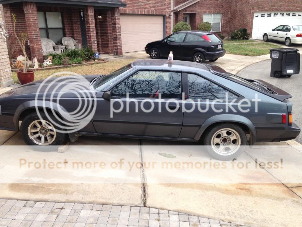

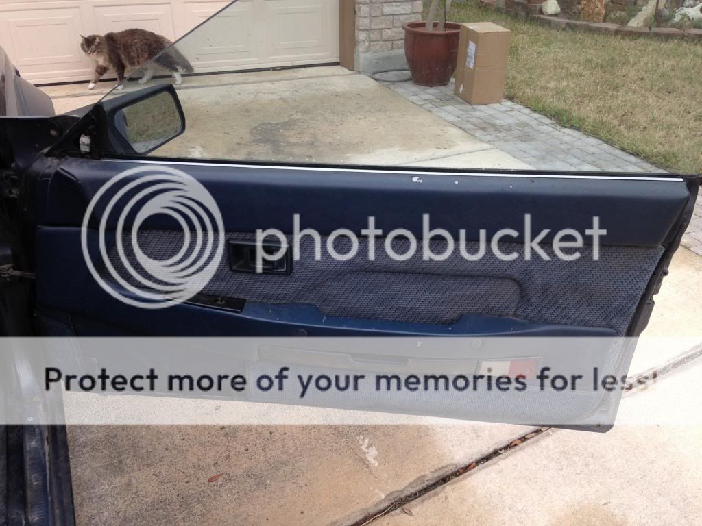

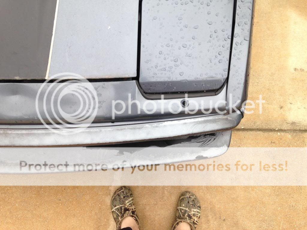

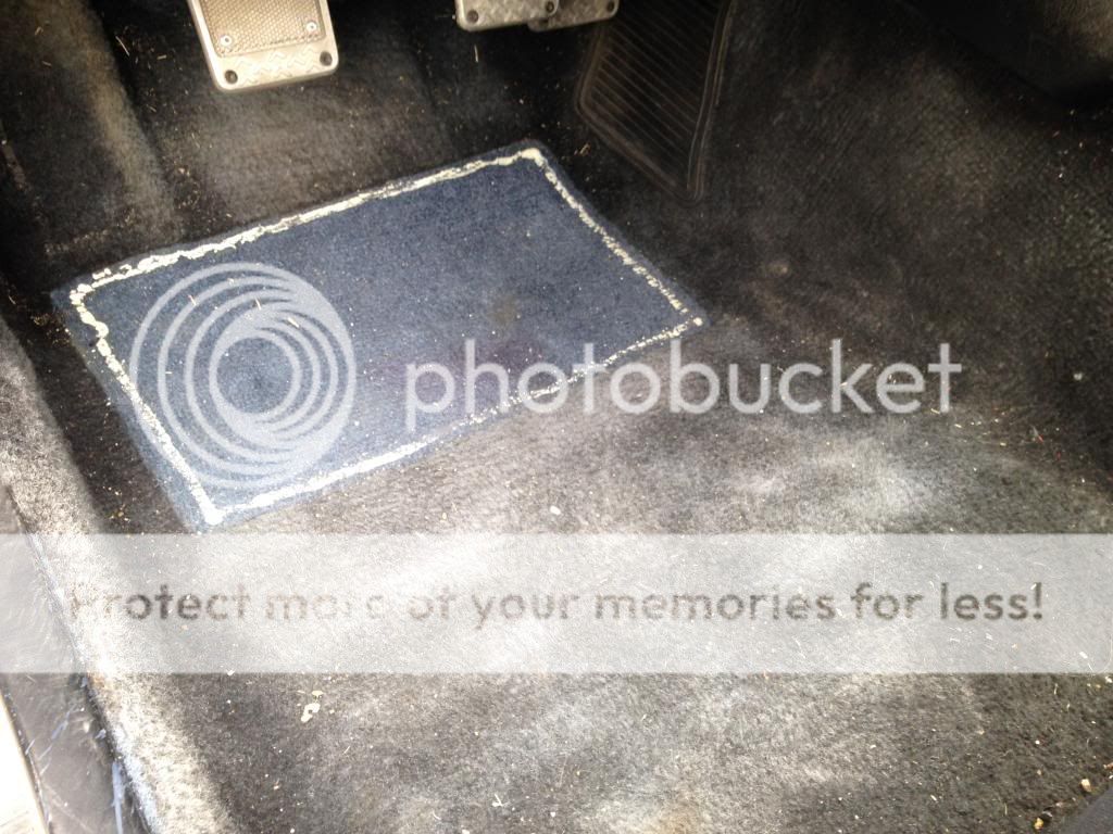

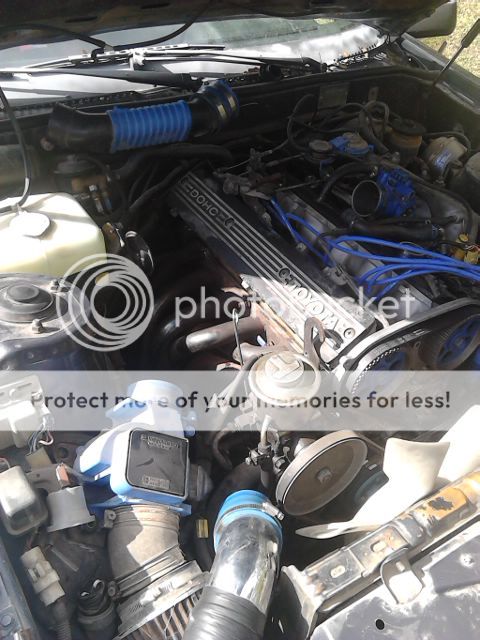

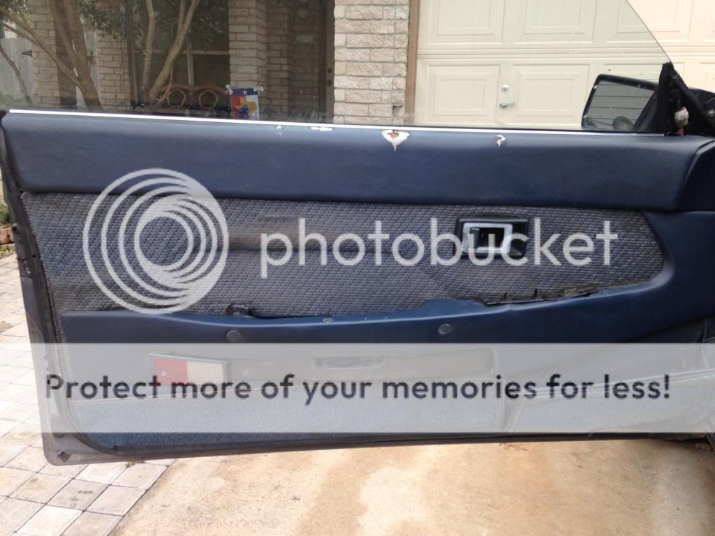

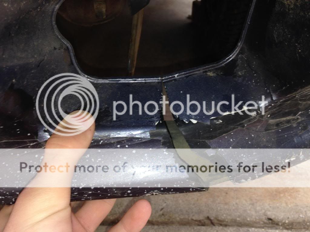

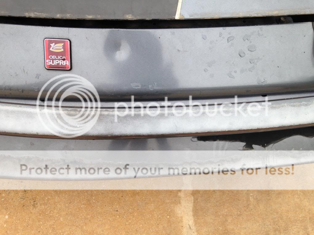

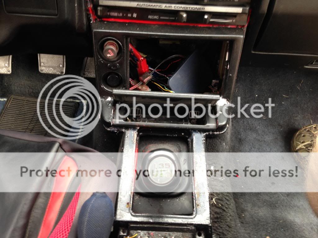

HELLO ALL!!!!!!!! After being on the Forum all this Time and owning a mk2 Supra I never Shared Her with the Fellow mk2 Enthusiast, So today I shall do so. BE WARRNED she is in a very bad condition and I soon Hope to Return her to he previous glory That She was once in, before The last owner decided to Do what he did to the supra. I bought The Supra For 500 as a car to Fix and sell but now that I have worked on it I cant Bring my self to sell the supra its like a drug. The supra 1985 p-type with the 5mge 5 speed With Blue interior as the car sits now the supra is having some sort of Timing issues/ignition witch is stopping it from Starting. Hope you enjoy her as much as I do.

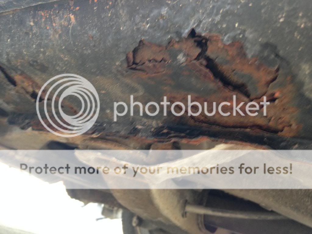

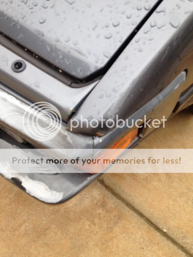

Only Rust I could find
She is a Fixer up for sure But I love her and that's what matter not what anyone Else thinks of her She mine.If I missed a area of the car you what to see tell me and I will post a pic
Also all pictures are From a iphone 5s So if they suck I am sorry

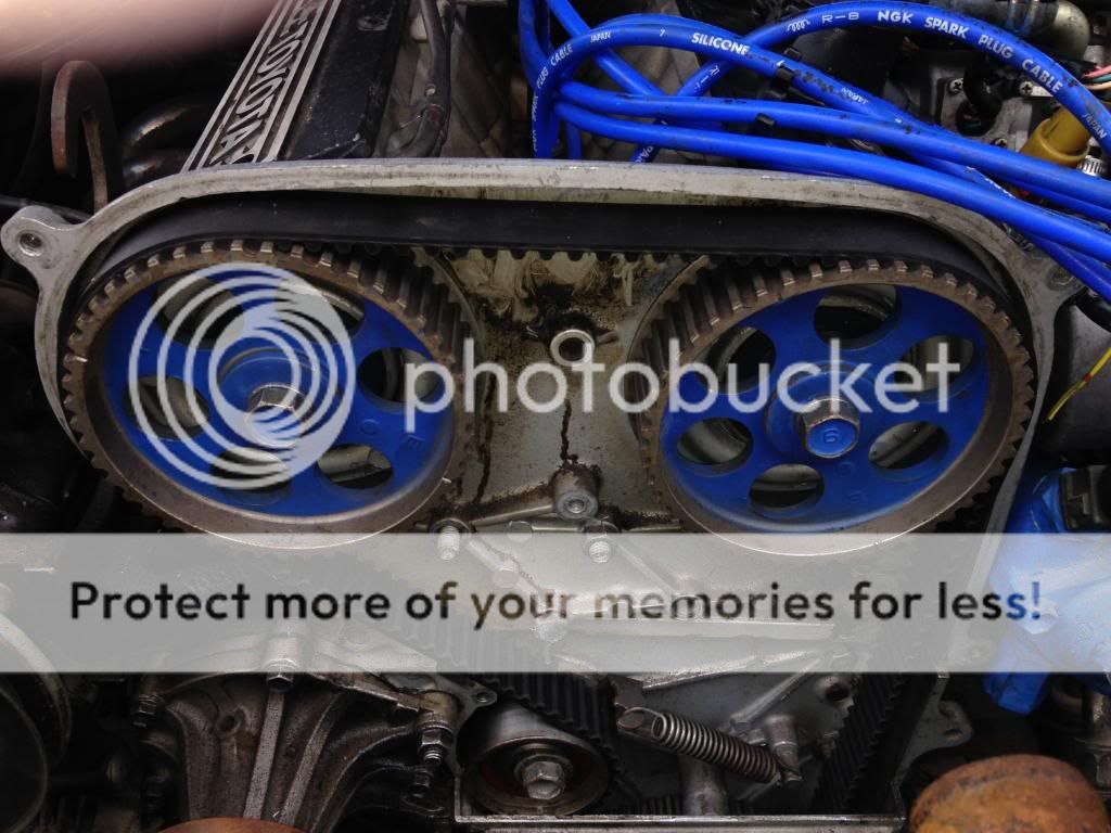

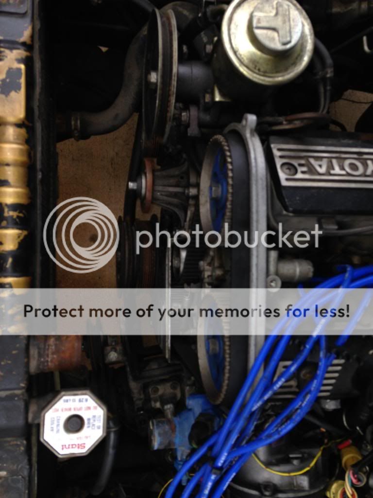

quick little Update so it Turns out there was no Gasket between the upper and lower intake manifold and non of The grounds we hooked up as well as injectors were unplugged and all had bad seals :-( also went ahead and did the timeing belt replacement too Wile I was in there and spark plugs and wires distributor and oil More pictures to come when its Finished

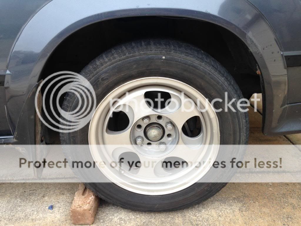

1. Please use wheel chocks on BOTH sides of a wheel. I always chock the wheel diagonally opposite of where I'm lifting the car from. I also apply the parking brake when I can, or at least leave it in gear.
2. Starting in 85, 5MGE engine didn't even USE an oil pan gasket. They use silicone or FIPG (form in place gasket).
3. That front left wheel looks to have a heck of a ding in the inner rim lip. Hope it's really just a wheel weight, as the pic is dark in that area. If that wheel has a slow leak, check around that ding for a crack.

The tank is being clean by a professional shop was not in too bad condition and the rim is the wheel weight and I took your advices a chock block both sides of the wheel also I have. Video just can't get it to upload. Also any recommendations on fuel pumps would help too
