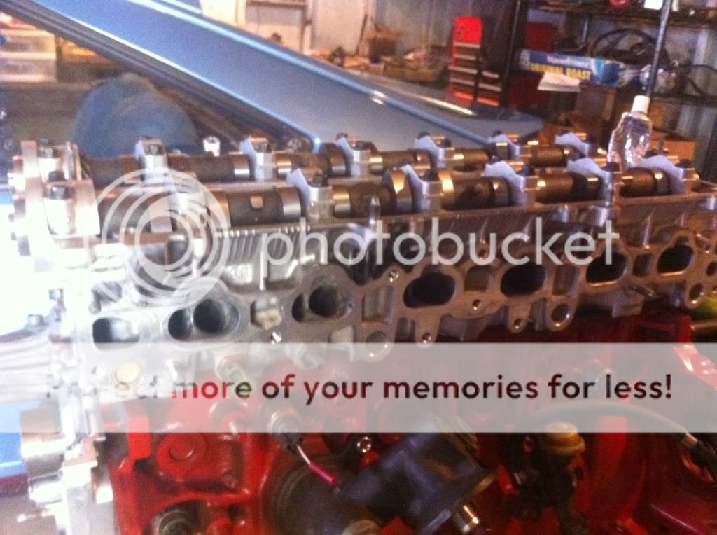

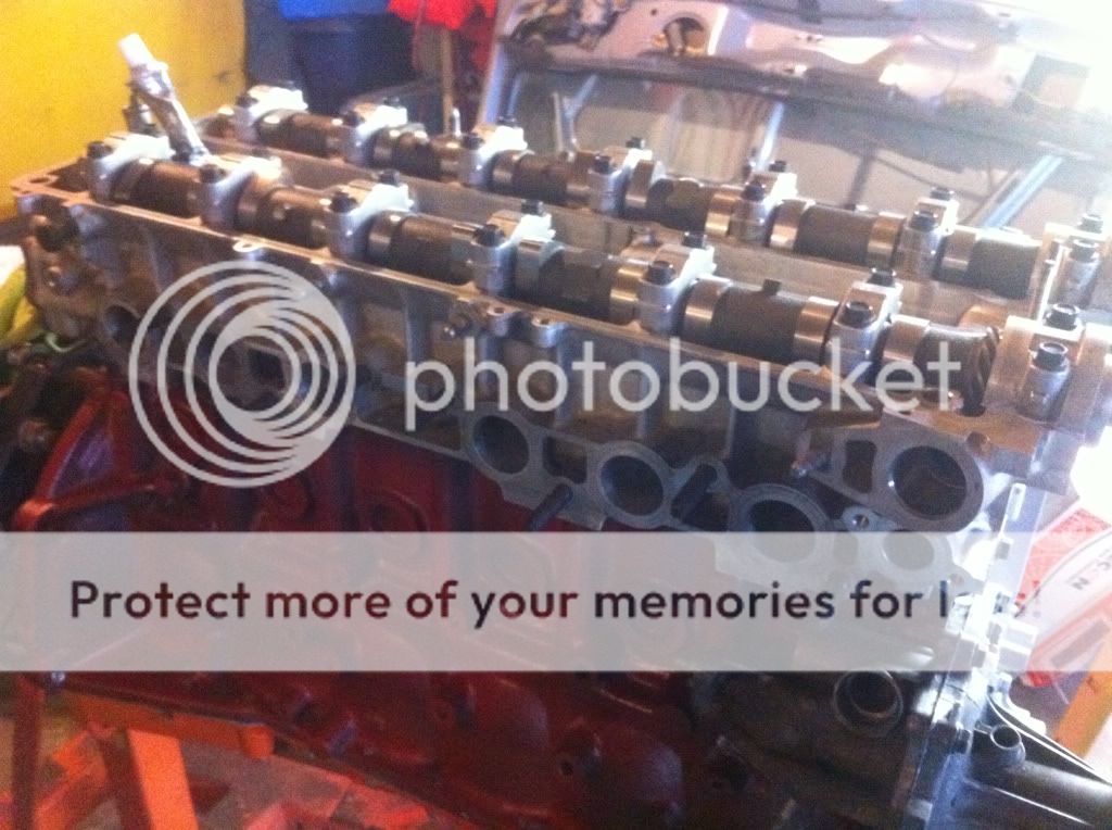

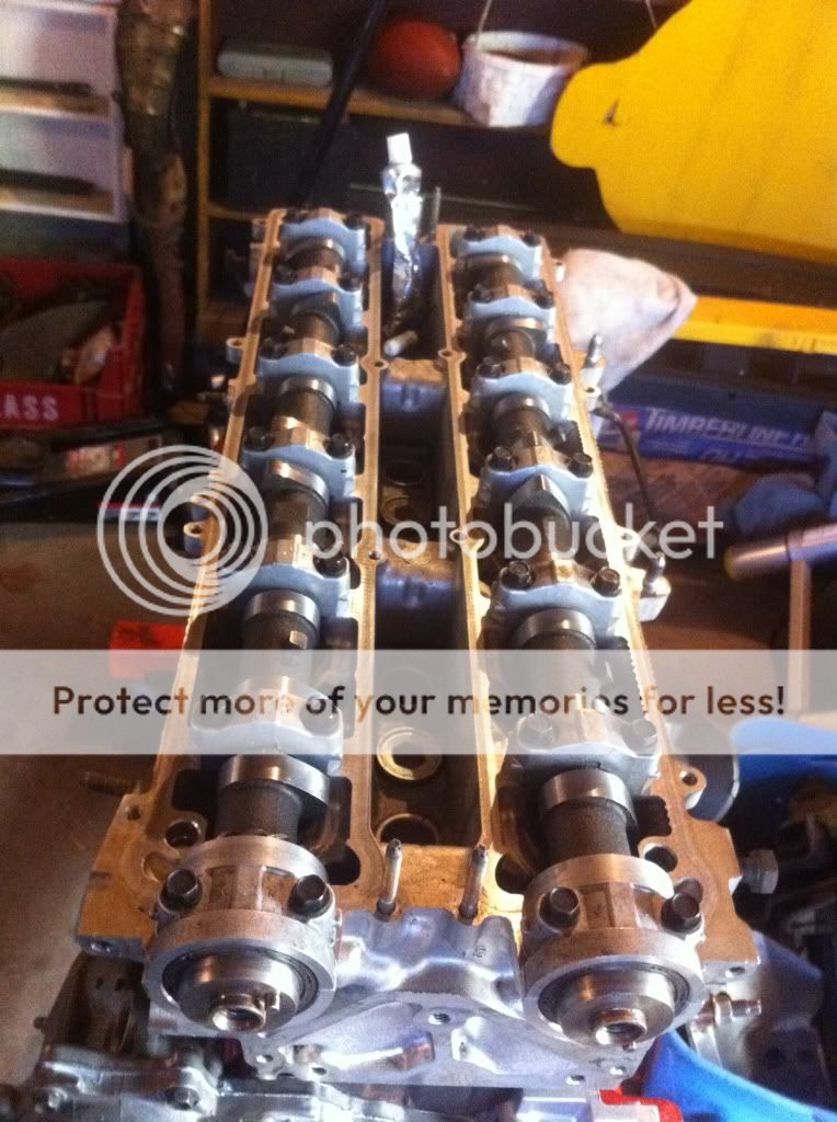

Small updates got the head bolted up and torqued down starting to get the timing system in order.
