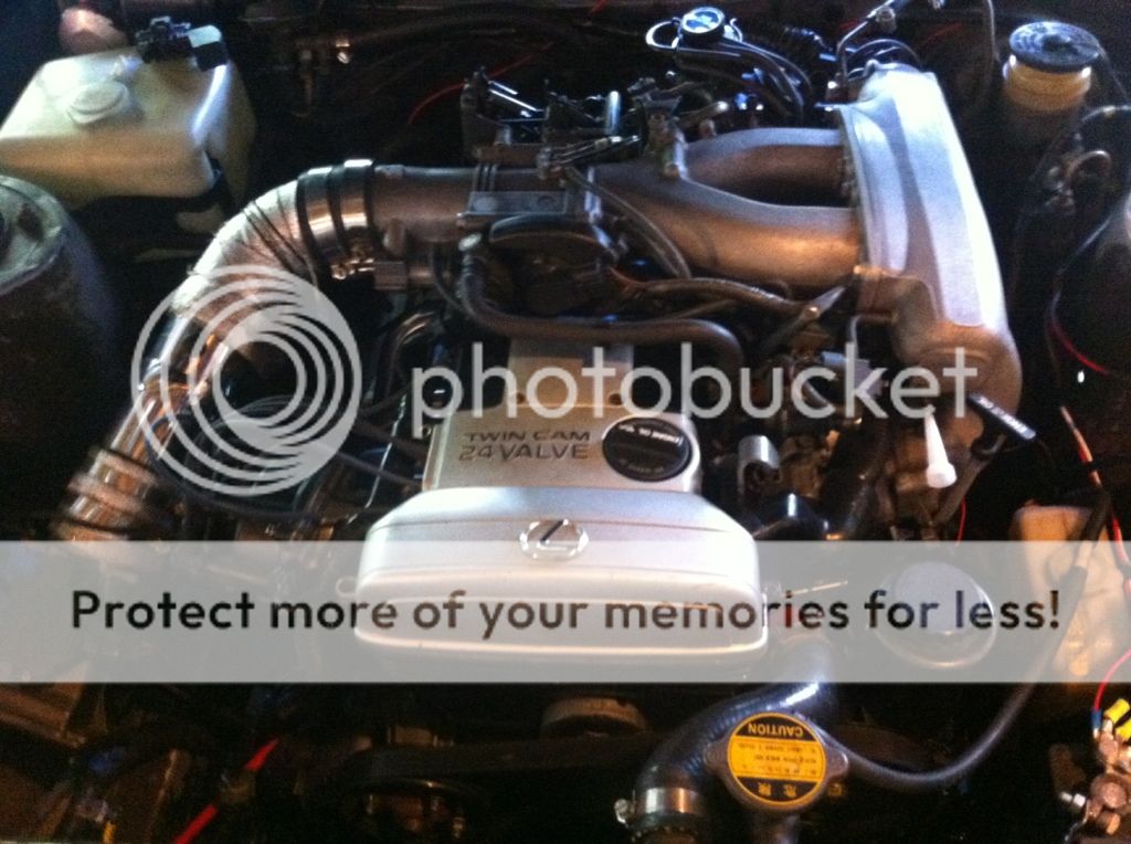

I have finally gotten around to digging back into it. I had a stuck exhaust valve. Pulled the head cleaned the valve up(carbon build up) and started putting things back together. ARP studs this time! I stripped two oem bolts.
1,599 Posts
Discussion Starter #77
Ok so too update this thread a little bit.
I have fixed the exhaust valve new oem headgasket and arp head bolts also added a oem fan clutch just need a shroud.
Had issues with idling fixed a hand full of broken wires. Still had a iacv problem. So I disconnected it and plugged vacuum lines. Idle is around 8-900 but steady
Now it runs pretty good! I was able to drive up and down the street and few times and it felt like it had some good power!!
Just need to wire up the temp sensor gauge and oil gauge. Change the oil again. Should be ready to tag and get some classic insurance!
