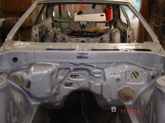

So after I stripped the interior of the silver car this is what I ended up with:
on this picture you can see the rust spots near the middle rear seat belt fittings. These were dreading signs that even in a car as nicely looked after as this one rust was existant. So I had to check everywhere and see if there was any other damage. Fortunatelly there was no other major rust anywhere else. The two spots appear to have been initiated from inadequate sealing from undernieth, where the two fittings bolt to the floor of the car.
So having stripped the car totally, having checked and sandpapered every dodgy spot there is, we applied Rust Bullet everywhere in order to make sure that the rust would not come back easily again - hoping that the greek warm climate will aid in that also.
Another issue that I was really concerned with was the factory construction imperfections especially at the rear of the car as well as reinforcing the rear body. And by talking about reinforcing we also spotwelded along the sidewells inside the car cabin so as to reinforce the main body and add some rigidity. We also did weld all the gaps that are undernieth the rear turrets:
