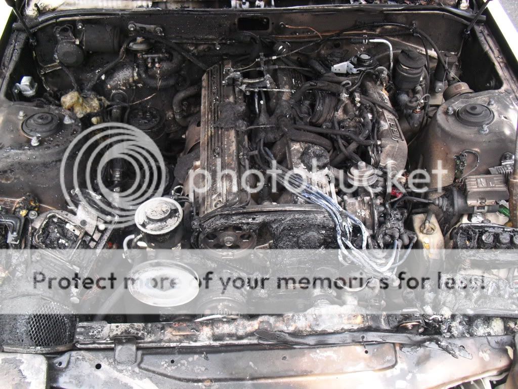

My '82 Supra caught fire. I need most of everything in the engine bay. I still have the block but thats about it. I have drive-line.

Here is a picture of my engine...

Wow, any idea what happened as to why it caught fire??

I did not have the battery secured as far as how the fire started. And for the engine, I do appreciate everybody's help but I do not want to pay shipping from all-over the country. I need something from Washington/Oregon area. Thanks everybody for the help.

Simply did not have the battery holder in place?? That's what started the fire??
Meanings can be totally misunderstood when it is strictly text. So I want to make it clear I am asking if someone with a LOT more mechanical knowledge than me can clarify that this is possible as being the origin of a fire.
I NEVER have any of the tie down bars in place on any of my vehicles as I find that one way or another at some point I'll have to pull the battery from something and (especially with bare hands in a Canadian winter) it's a huge PITA,
If an actual mechanic can verify that this can actually happen, I'll have to at least adjust my thinking and at least put some kind of bungee cord system in place or something that can hold the battery in place ...but at the same time can easily be unhitched to allow access.
Once again, I am ASKING if this is possible, for my own knowledge, as I (personally) would not have thought this is possible...but I am definitely NOT a professional mechanic.

Sure it can, your positive terminal can short to ground if you are doing some hard cornering.

Yes. The only reason my car caught fire was that the battery was not secured. When I made the left turn, it slid into my radiator and sparked. Which caught the terminal on fire and sending the flame to the sound supressor under the hood.
2,401 Posts
Dave this is very possible (which i know personally). Luckily i noticed some of my electronics going a lil skitzy and i popped the hood and fixed it immediately. Battery hold downs are NOT for decoration and even tho they are a pita sometimes they are a necessity. Here in pa they are required for safety inspection and for good reason. It may only be 12v but as his pics show thats all it takes sometimes.

Thanks for enlightening me me ppl...I'll at least make sure there's the rubber covering over the actual positive clamp.
When it gets warmer in the spring, I'll figure out some kind of quick release system (for all my cars) even though it'll be non OEM. I'd still find it a PITA to have to undo nuts any time I need to pull a battery.
Actually noticed last year that my ex's car had a different battery that was actually a little too "tall" for her car. The terminals were actually digging a hole thru the hood padding. I put some rubber (bike inner tube actually) over the clamp to prevent it shorting out if it did finally make contact witht the hood, but still wasn't thinking it could actually start a fire. I'll make sure to inform her to make absolutely sure that nobody pulls the covering off.
Thanks guys (though I'm sorry about the situation that brought it to my attention)
