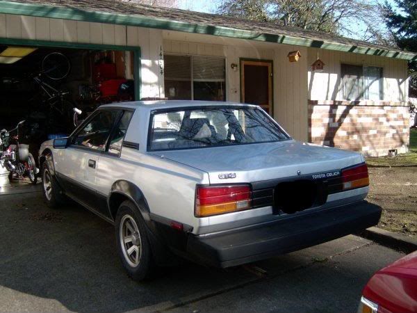

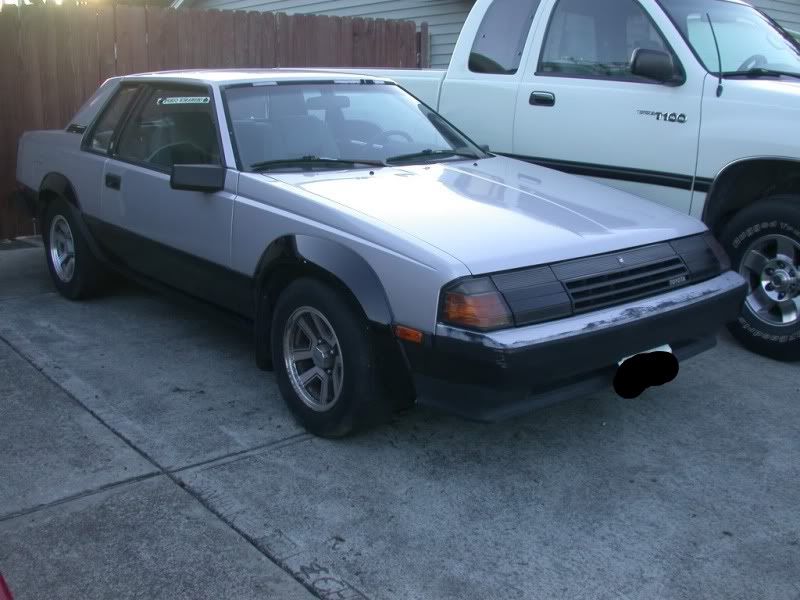

I hope that I am welcome here. I have a 1984 RA65. I bought it from Sambone a little while back. I work with him and RA24MAN so I get alot of exposure to these types of cars.

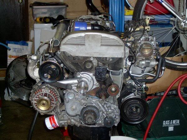

My car dosen't run. The 22RE is on is way out of the car. In its place will be a 4G63 with a R154 trans. I am hoping for a couple of sunny days (no rain) to get some wok done on it.

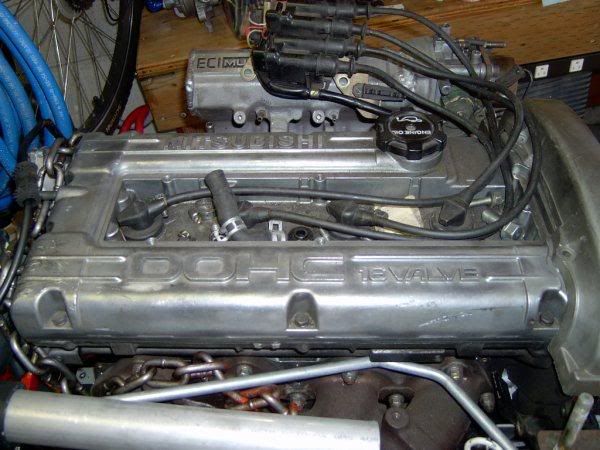

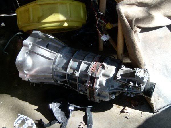

The bellhousing is a custom unit. It uses a hodge podge of clutch parts. My only challanges are the cam angle sensor and water outlet at the back of the head. I am hoping that the recess in the firewall is enough for clearance. My bellhousing is about 1/2" longer than the W58. I will be mounting the R154 in the stock location. The throttle body already has been moved to the other end, and the turbo turned 180 deg.
I love my Cartech (Corky Bell) intercooler. Small but very efficient.

I didn't know the R154 had a 'stock' location in the RA chassis'! LOL
Looks very cool though, did you just happen to have the 4G kicking around? Using the stock ECU for the 4G?

I meant the same location as the W58 and not moving it back like the 1J/2J swaps. I guess the R154 dosen't have a "stock" location.
I owned a 1st Gen GST DSM a while ago. The car was crap but I love the power of the 4G. Fwd is also crap. I had other plans for the engine and trans, but things change.
I will be using stock electronics for the time being. It has a 16G turbo and 2G maf. Nothing special.
