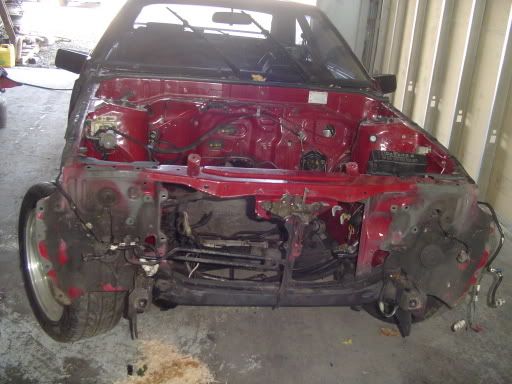

1st, the car

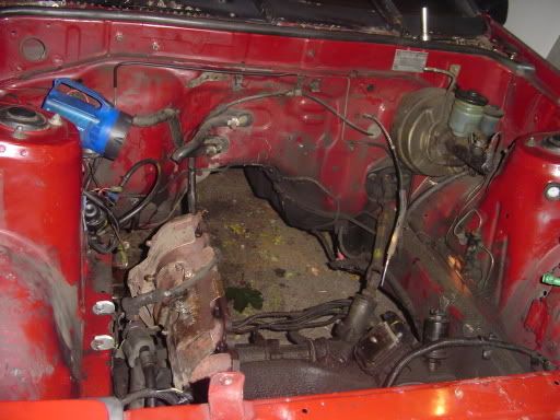

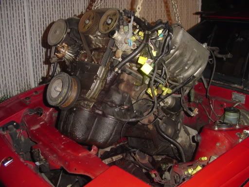

than removal of the engine (all by myself :D)

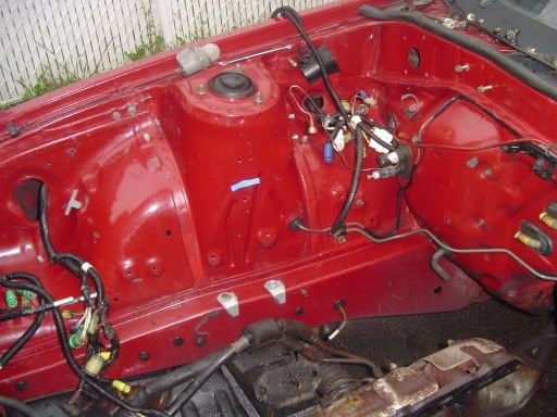

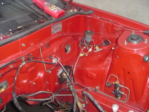

Cleaning the engine bay....

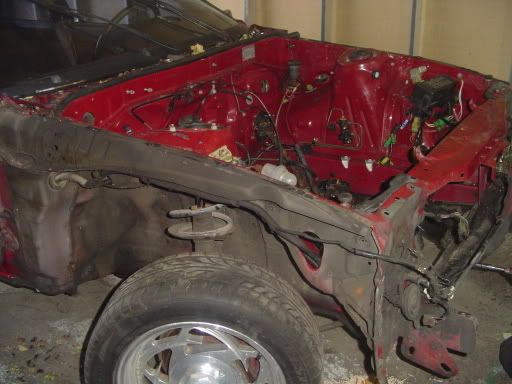

than we removed all the front panel for easier access to engine bay and to avoid 'accident'

Why we removed the front. By taking off the front bumper, we have an extra 2 feet to work in the engine bay and to fit the large IC, and once front but is off, takes about 5 minutes to take off the front fender. It's a little bit more work, but this way, we will avoid any body scratch.....

what are you doing with the old motor, just curious?
Engine was leaking oil from all possible area.....it will eventually be rebuilt and put it back in a nice mkii.....maybe, don't know yet.....
