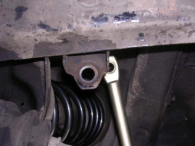

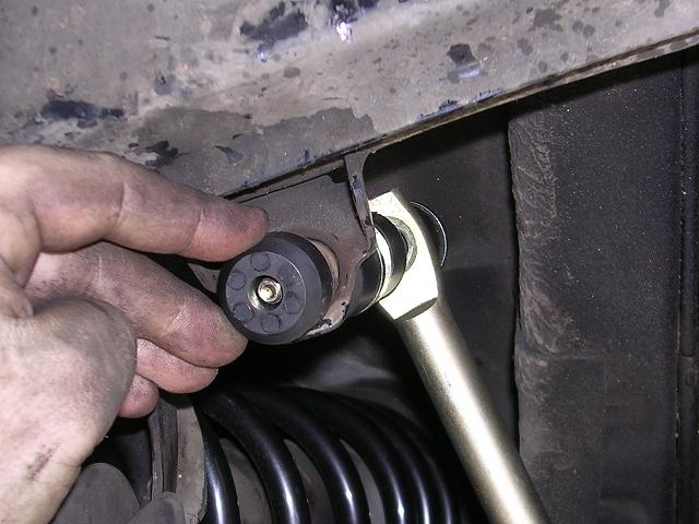

I've run into a problem installing the rear sway bar. I've looked at the swaybar install topic, which looks to be very straight-forward...but mine doesn't quite fit. The ends of the sway bar don't quite center over the mounts, making the end link drive through at an angle. This ,coupled with the end link bolt barely being long enough to thread the nut onto even under ideal fitment, doesn't allow any thread to make it to the other side. I'm looking for suggestions if others have run into this before.

Bolt up the endlinks first then the frame mounts and you wont have that problem. Also make sure the car is supported with jackstands under the control arm instead of the frame to keep the suspension compressed.

SupraWes: Ya know...I had that thought at one point, then it went away and never came back. I had supports under the control arms, but with doing it backwards, it just wasn't enough. All good now though. :)
