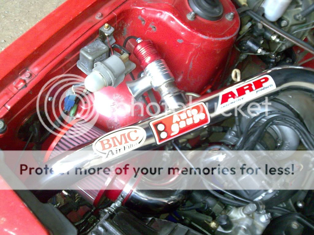

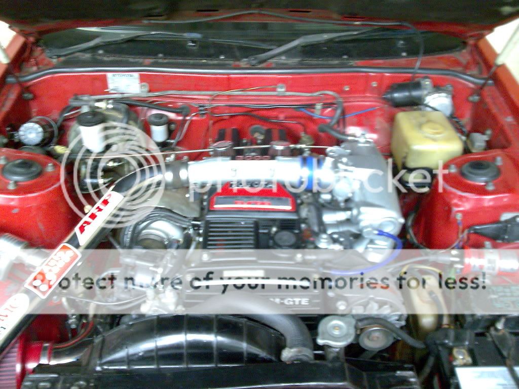

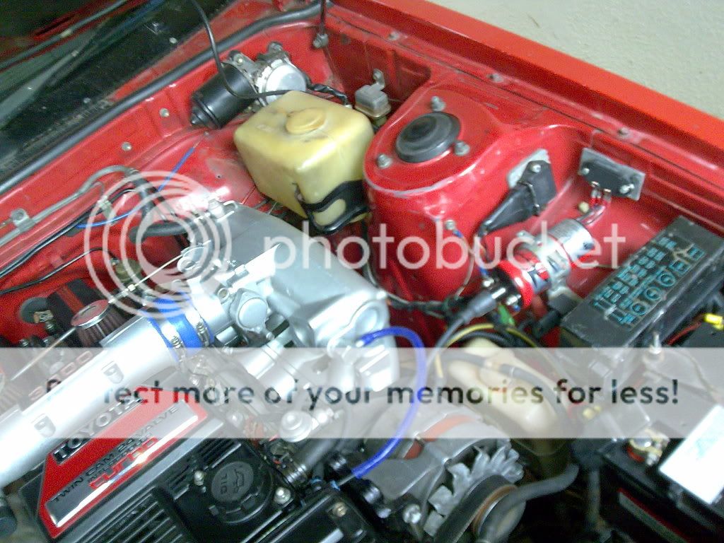

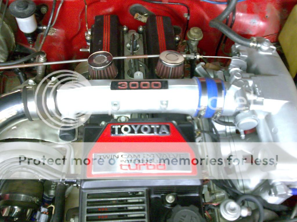

Looks clean, where is the TPS?
No TPS. I've been asked this question somewhere else in this forum before & after consulting with my mechanic, other mechanics & the local management expert, I was told that the management system I am using does not require it.
