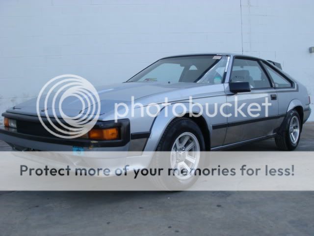

this is my baby.
picked her up Thursday and love it. right now, I'm trying to get her to start on her own, It would crank and sputter, so today, I went ahead and sprayed some starting fluid in and she started right up, warmed up, and idled down, so I'm thinking maybe a sensor or cold start injector, but ill figure it out, I've been using the search function on the forum and have found some good posibilities. Before that i was dealing with a really loud "clanking" sound that i was assuming was valve noise and after warming it up and playing with the throttle, it has gone away, I'm really glad it went away i was praying for air in the lifter lol and not a rod-knock. It feels great to start with a running vehicle. well, ill update as i fix and fiddle with stuff, that's all for now.
SouthTexasSupra.

Looks good. It has the hockey stripe so it looks like it came from the east coast if im not mistaken. Or southeast?

thanks everyone, i would rather it been a P than an L for the rear end gearing and horsepower so yet another thing to be exstatic about.
Horsepower is probably about the same. Rear end is def. the same between 5speed Ps+Ls. Ptypes have better seats and more clearance for bigger wheels and tires though!
5,448 Posts
Welcome. Thats a P-type. Not an L.
Um, I will say it again, the one you have pictured is a P-type, not an L-type, HUGE giveaway are the fender flairs, unless if someone went through the hassle of swapping fender flairs on it.
Unless if I just read your post wrong......
And it is a nice Supra also, one of my fav color options.
Nice color! If you want some ideas on looks, check out Tanya's "Coyote Ugly" thread. She had an 84 like yours, right before the black Supra she has now.
