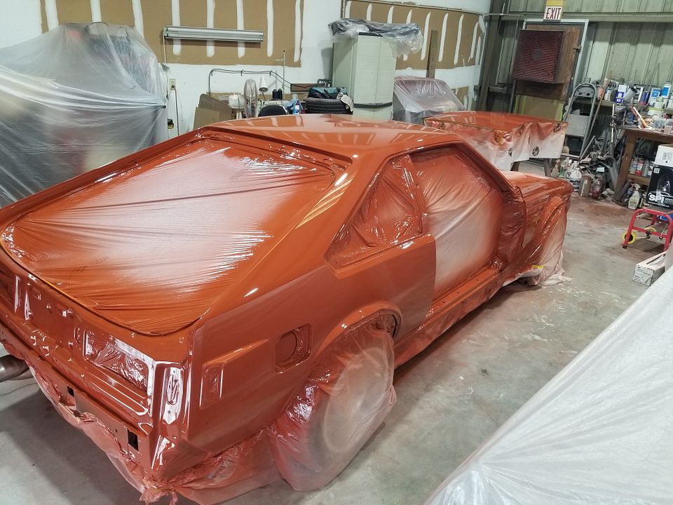

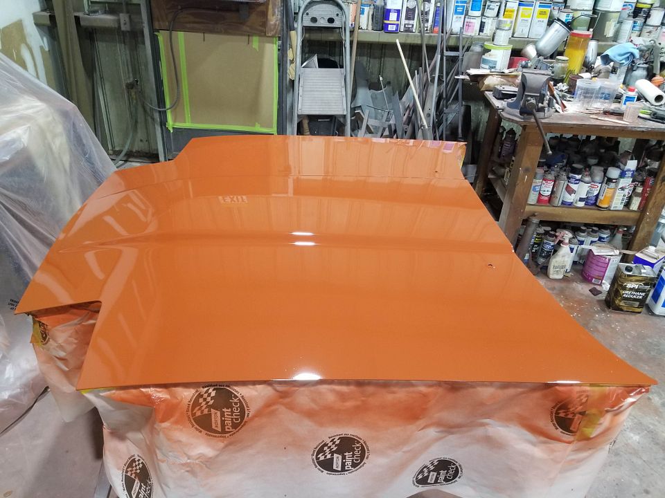

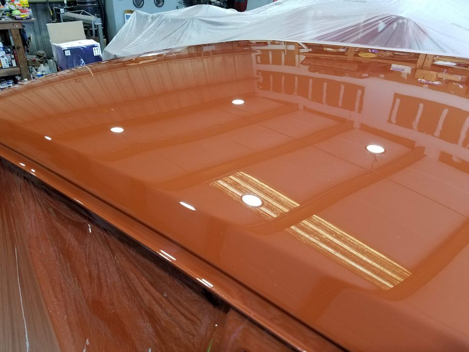

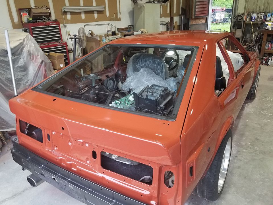

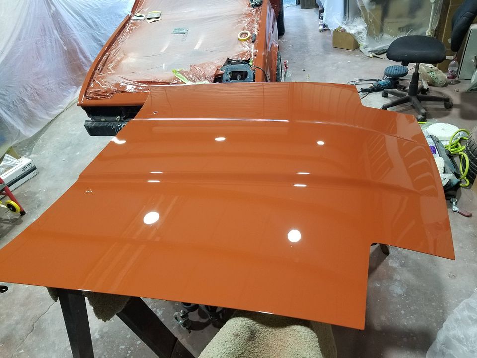

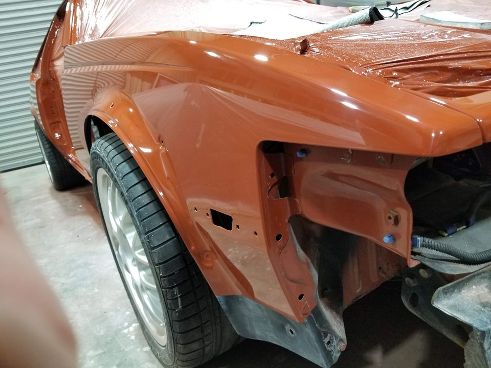

Car is painted! Used the PPG DBC base and some SPI Universal clear. First time using the SPI clear so it took a bit of fiddling with gun settings and pressures but I think it came out pretty well. Have to cut and buff to get rid of the trash and a few oops.
After it cured for a week I sanded and buffed all of the parts. Still have to paint the flares, 85 spoiler and the bumpers.
Now you are all caught up with where I am now with the project. It has taken a while to get to this stage. Now I can start putting things back together which means restoring all the parts I took off. Quite a pile of pieces and each one needs at least cleaning.

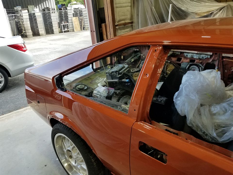

I have been working on lots of small things that needed to be done. Cars come apart quickly but take forever to put back together when every piece needs some sort of cleaning or restoration. I got the hatch glass reinstalled with a new gasket. The old 1982 one finally gave up on the third removal. I am using the 85 spoiler so I don't need the trim on the gasket.

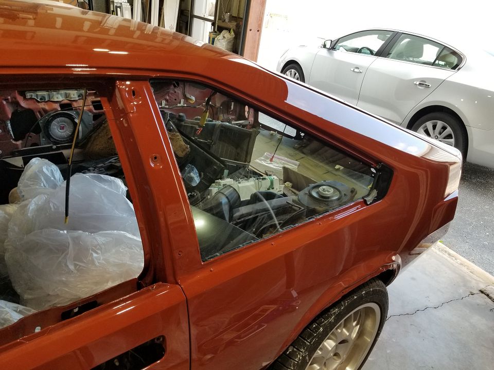

Cleaned and reinstalled the rear quarter windows. Working on the trim around them. Going gloss black.

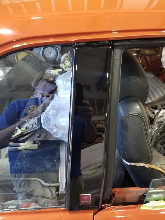

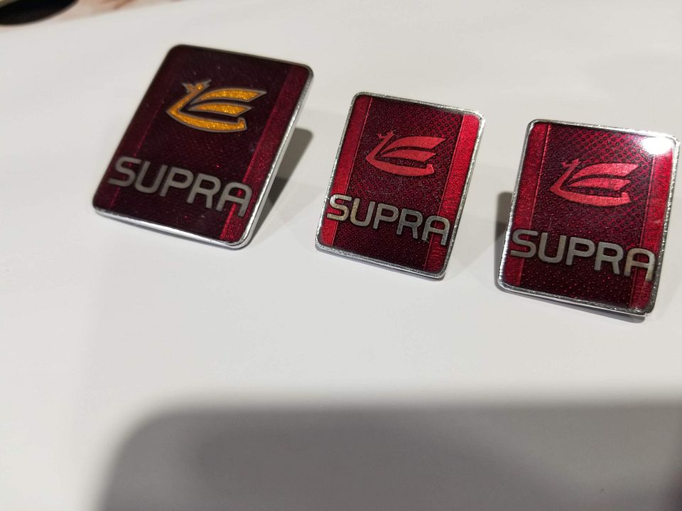

The pillar trim was pretty sun baked and crazed so it got disassembled, sanded with 220 then primed with 3 coats SPI epoxy black. After cured that was sanded smooth and top coated with PPG DCC9300 black urethane paint. It didn't come out as smooth as I wanted so it got cut and buffed. Came out well. Emblems got cleaned and the chrome edges which had weathered off got coated with a chrome paint pen before reinstalling.

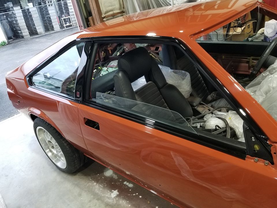

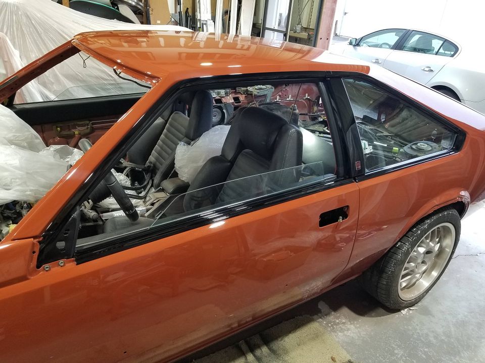

Side window trim is done! Painted them the same gloss black as I did the b-pillar trim. Still need to do the mirrors and the winshield trim.

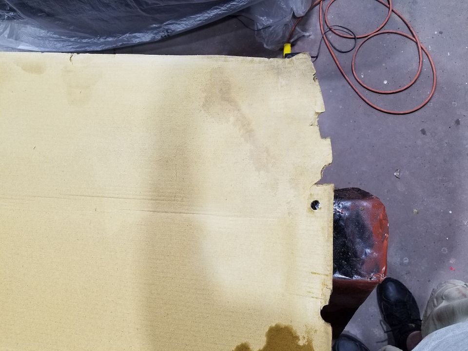

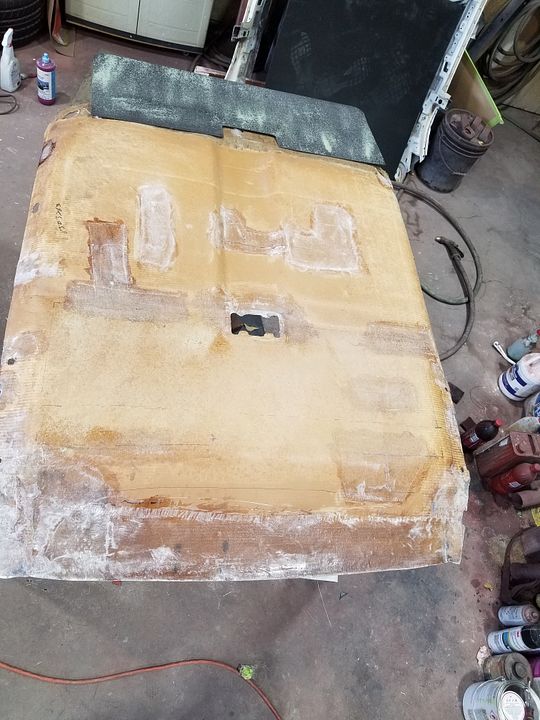

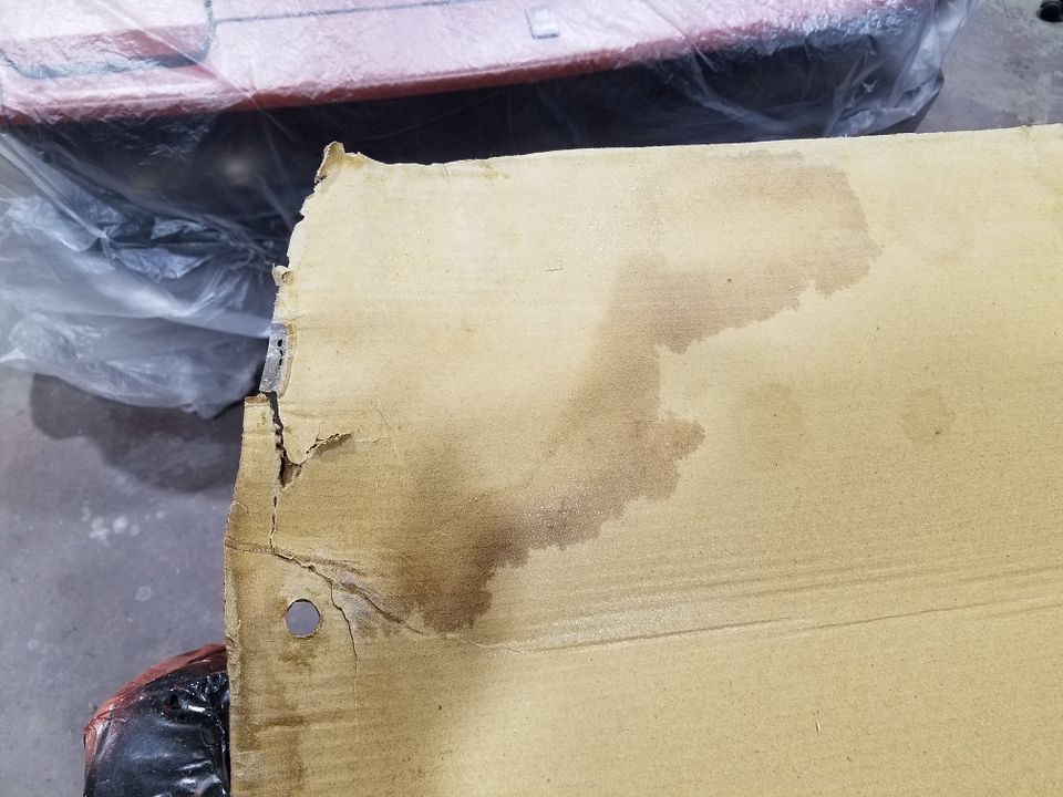

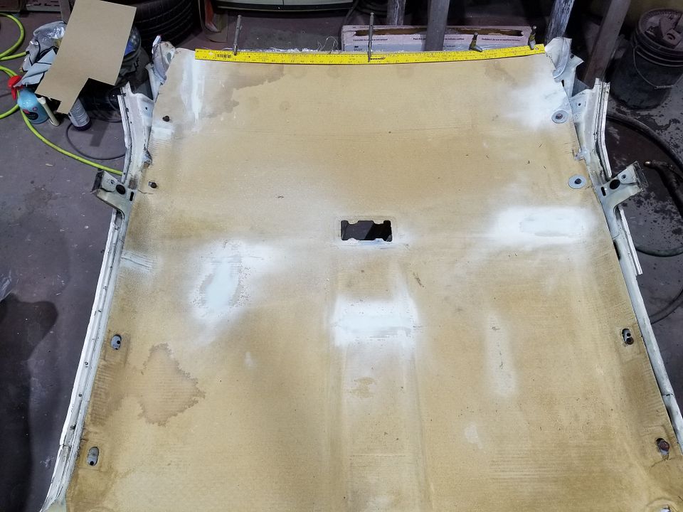

Well things have been happening but I have not posted lately. I decided to work on the headliner for the hardtop roof that came with the roof cut. It turns out it was not in as good a shape as I thought. To top it off it is made of cardboard! The sunroof headliner was made from a pressed jute type fiber and has held up pretty well.

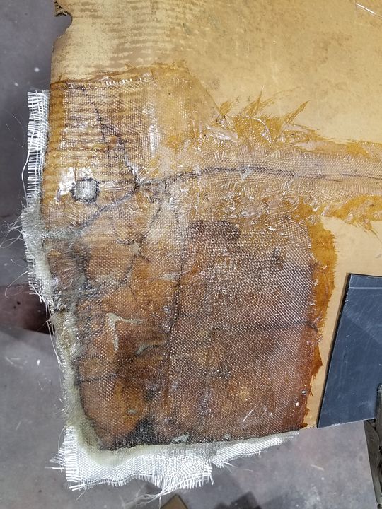

Some time in its previous life the cardboard suffered some water damage at the rear due to what I suspect was a leaking hatch wire grommet.

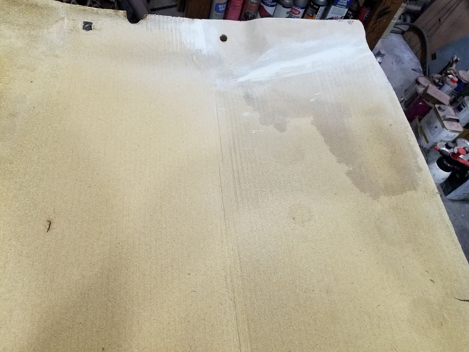

So I decided to cover the backside of the damaged area with a layer of fiberglass cloth and resin. The visible side got a layer of chipboard glued on the damaged area to hold everything together.

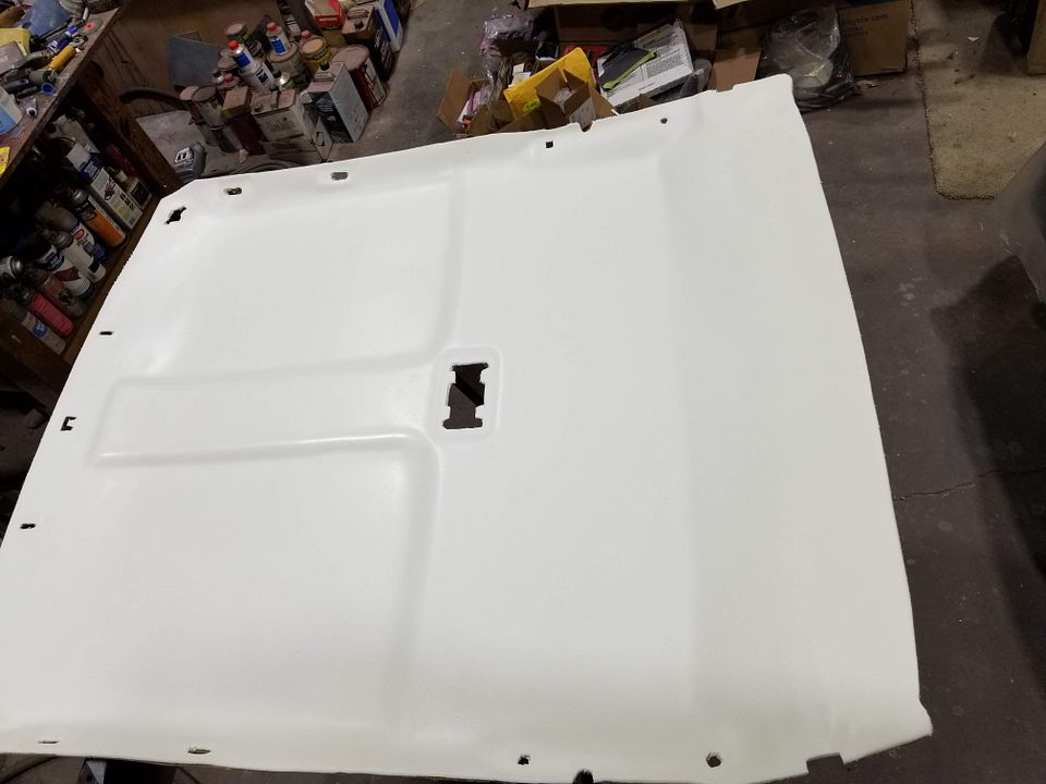

The rest of the headliner had numerous cracks, splits, tears, etc. I applied fiberglass to the back and filled the front if necessary with some 2-part spot putty.

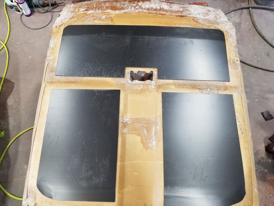

I worked on it when I could with it anchored to the roof cut framework so as to maintain the shape and support the fragile cardboard. Once I got the cracks supported and smoothed as much as possible there were still some waves in the cardboard that I did not like. I made some panels from 1/8" expanded PVC to glue to the back side in the larger fairly flat areas. This pulled most of the waves out.
Still needed some smoothing so I glued 1/8" Volara foam on the front which gave me 1/8" of "filler" to sand.

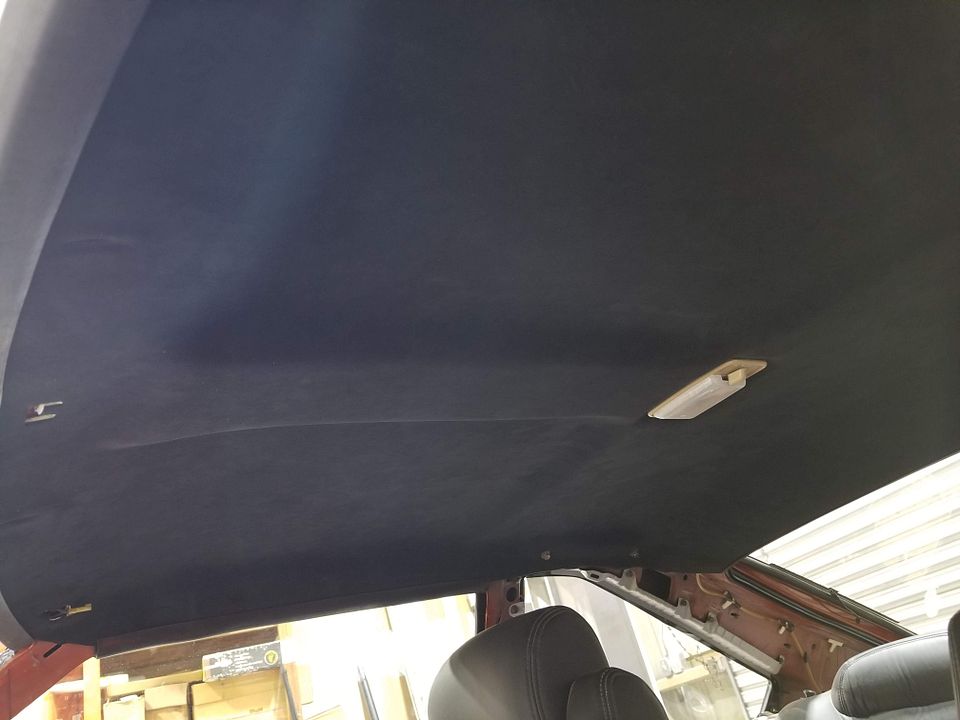

Once I was satisfied with the surface I glued on some black Alcantara over the foam.
It was a little tricky to get it laid out smooth and wrinkle free but I think I like it
Still need to paint the new dome light I found. Could not find a black one.

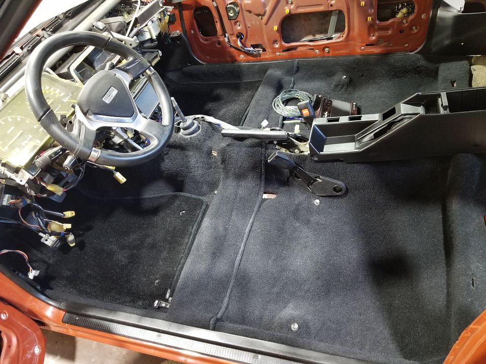

The project this weekend was installing the new black ACC carpets and Lloyd floor mats. It took a while to fit the edges and cut all the holes but in the end it looks good. The picture makes the carpet look grey compared to the mats. Both are black but the mats are a deeper black. A few spots around the seat mounts took a little bit of heat gun application to get them to sit right, but overall the carpets fit really well.
I cleaned up the two console pieces and fixed a few cracks and warps then re-dyed them with some SEM Landau black color coat. I set the main console in the car till next week when I can install it.
