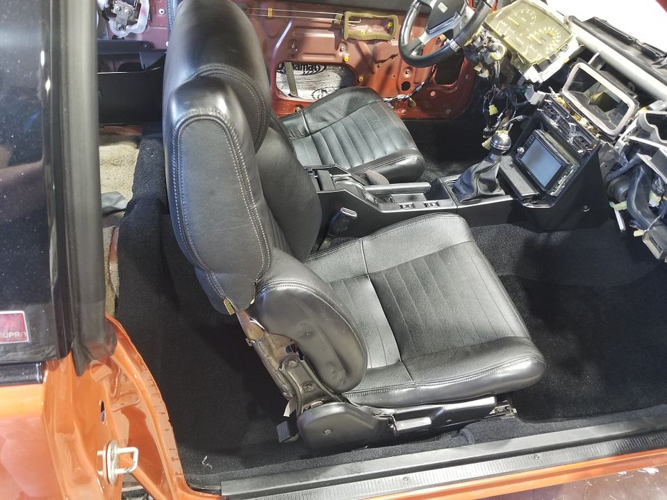

I cleaned up the seats and got them reinstalled along with the center console. The old group buy leather covers are still looking okay even after 10 years of use! Seat backs are recovered with new chrome trim but forgot to take pictures. Center console armrest is getting a new cover but not done yet.

Well got some things done over the weekend. Seat backs are covered and have new chrome edging. Lumbar inflation bulb got replaced. I started on the interior trim under the quarter window and got partway done. They are getting new vinyl on the top and the bottom half is getting the black tweed I put on there 12 years ago ripped off and replaced with black Alcantara like the headliner.

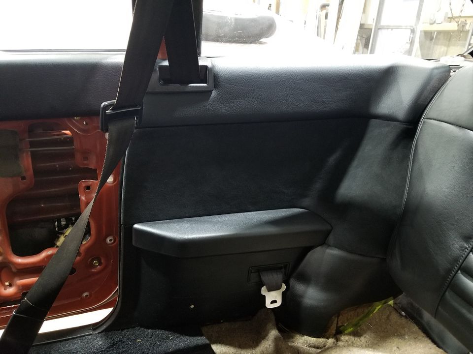

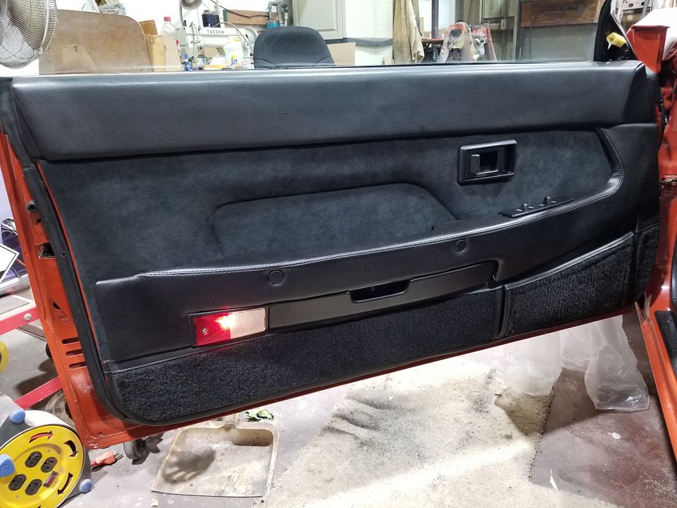

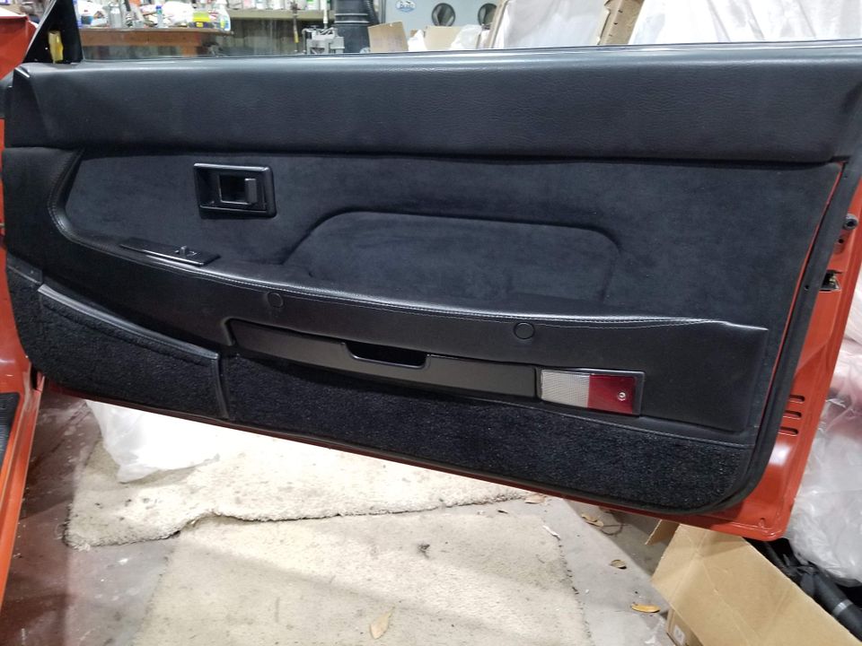

Finally got the door and quarter trim panels finished and updated to Alcantara to match the headliner. When I originally changed the interior to black I had used some black tweed which i got tired of and it had faded some so it was time to update.

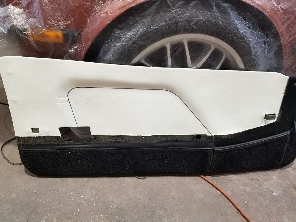

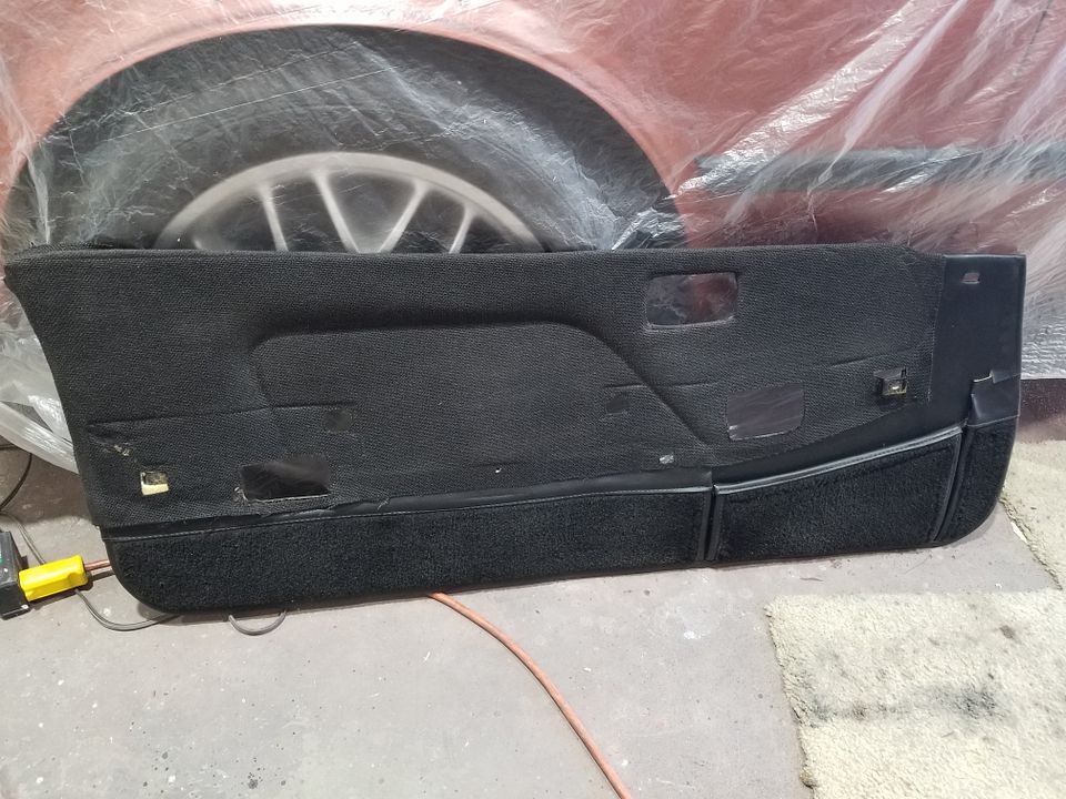

My door cards are made from expanded PVC to replace the rotted masonite originals. This made reworking them much easier. I ripped off the old tweed and the foam came with it so time to refoam and cut in the style line which I have marked on the foam with a sharpie. I carefully cut a V shape leaving about an 1/8 inch cut down to the base. Ends up looking like \_/ so that there is enough space at the bottom for the glue to hold the Alcantara. I sanded the foam and smoothed out any lumps and bumps.
Then using sprayed Weldwood HHR contact cement I attached the Alcantara. After cleaning up the parts of the door panel and reassembling it I reinstalled it on the car.
I did the same on both sides.
Not a good picture but I also did the same to the quarter trim

My door cards were rotted the same so I made some out ot 1/8" black expanded PVC. This allowed me to mold the style line in by clamping the PVC to the original and using a heat gun and some wood I pressed the softened PVC against the original card. It took a little time but came out well. I then transferred all the holes and brackets, clips, etc. I found that a forstner bit worked best for drilling holes in the PVC. That and a dremel for the odd shaped holes.

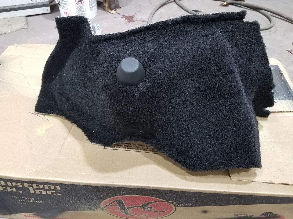

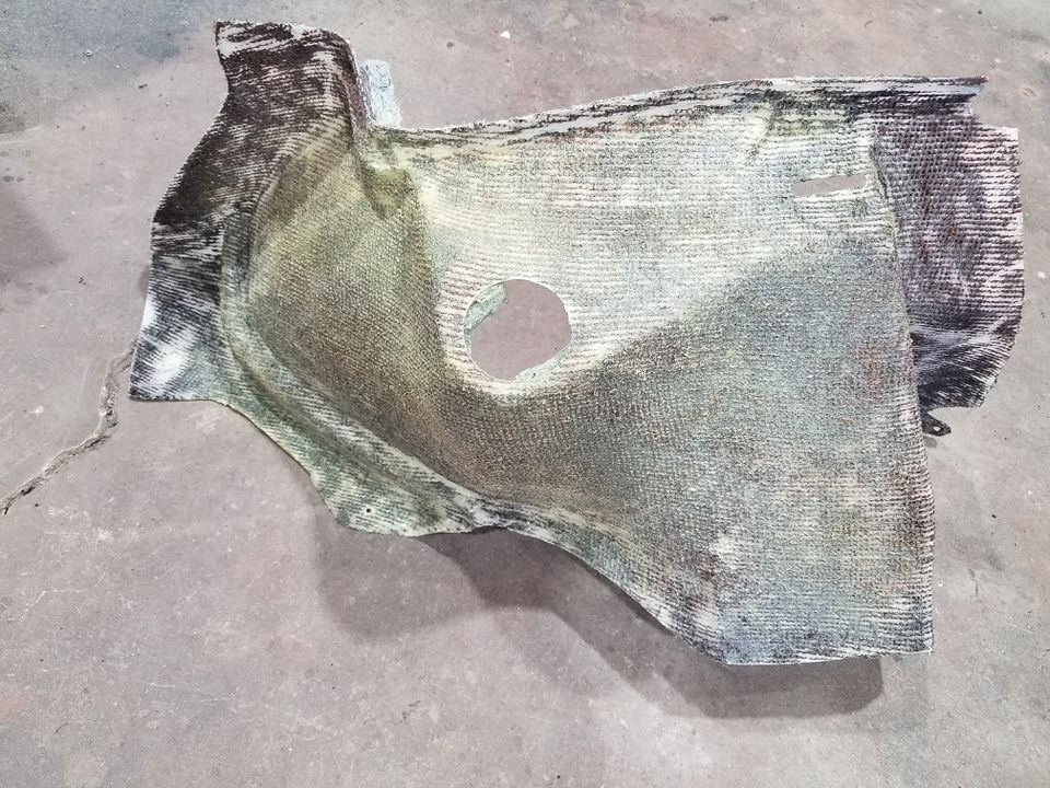

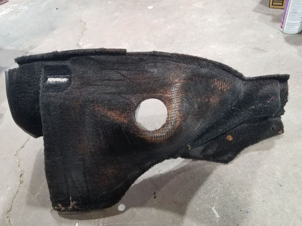

I was working my way towards the rear of the car to prep for new carpet and decided the shock tower covers were not going to work in their current state of decay. I had dyed them black when I change interior colors and now the sun has just destroyed the carpet fuzz.
When the covers were manufactured the carpeting and plastic backing were heat molded together so there is no way to "peel" off the carpet. I found a combination of 60 grit roloc and a stripping wheel got the carpet off down to the plastic base. Still had little bits stuck in the surface but good enough to glue over. Took a while and a technique to not melt the carpet fibers while removing them. If they do melt just move on and come back once they cool off.
I was worried I would have to put a few seams to get the carpet around the shape but managed to do it with just one sseam to the outside of the shock cap. I had to apply a pretty heavy coat of HHR glue to both surfaces because of the texture and porosity of the carpet. The carpet was some extra yardage I had ordered when I did the door panel color change years ago. I still have to install the edge trim on the front edge of the panel.

Discussion Starter · #78 ·
pdupler I did not actually sew anything just cut the carpet as clean as i could with sharp shears and glued it down. Sort of like a regular house carpet would be joined. i marked on the image where the joint is. From this angle you cannot see the joint but from straight overhead it can be seen. I am going to try to put the vinyl edge back on the front edge if my cheap commercial sewing machine will do it.
