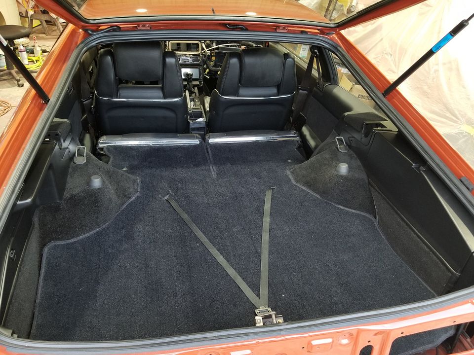

I am stiil making progress just have not posted any updates recently. Got the rear of the interior freshened up and put back together. Tail panel is not in yet so I have access to taillight and bumper bolts.

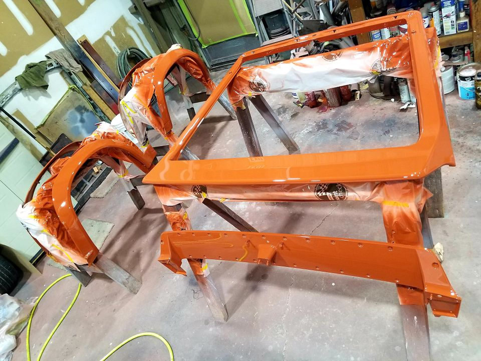

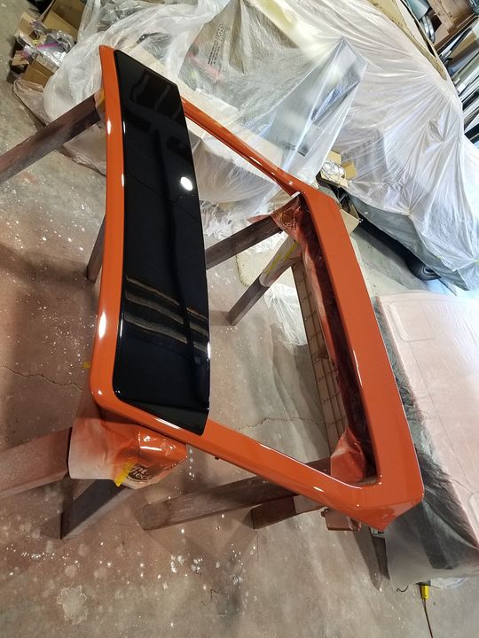

The flares and 85 rear spoiler are painted.
I cut and buffed the flares and got them reinstalled after cleaning the black edge moldings and reinstalling them with some weatherstrip adhesive.
I also cut and buffed the hatch spoiler and sunshade but still have to install a new set of weatherstrips and reinstall it.

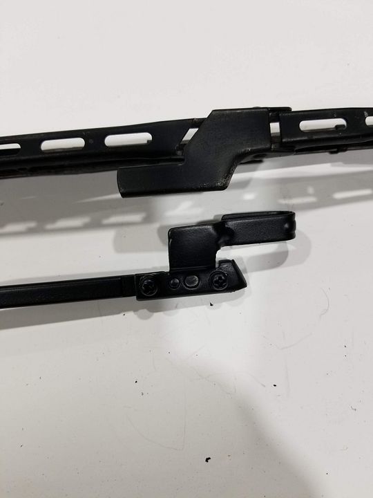

Still making slow progress. Working on wipers and got the fronts converted to use replaceable blades but the rear they do not seem to make an adapter that puts the blade on the upper side of the arm like the original so break out the hack saw and make two cuts
Redrill the locator hole
Weld it back together in the proper configuration.
Paint to match the arm.

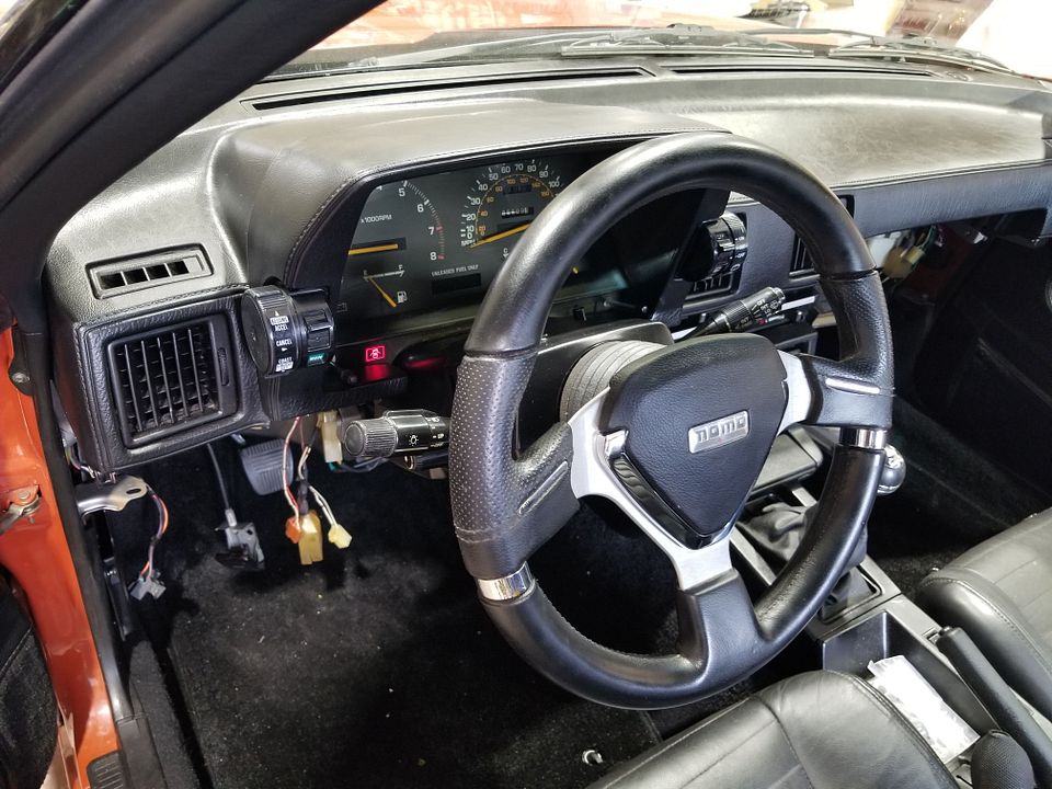

Windshield is in and moldings painted and installed along with the side mirrors.
Interior A-pillar trim was sun deteriorated and had some cracks. A simple redye was not going to work so I wrapped them with some of the same vinyl I used on other interior parts. Took some heat gun application to get around the ends and used some Weldwood HHR contact to stick in down. Came out well.
Dash is back in along with the gauges and controls. Verified that all the switches were functioning before reinstalling. Some were not and needed a good cleaning of contacts. Cruise main switch, rear defrost and rear wiper were being difficult but got them all working.
Haven't done the lower dash panels yet.
