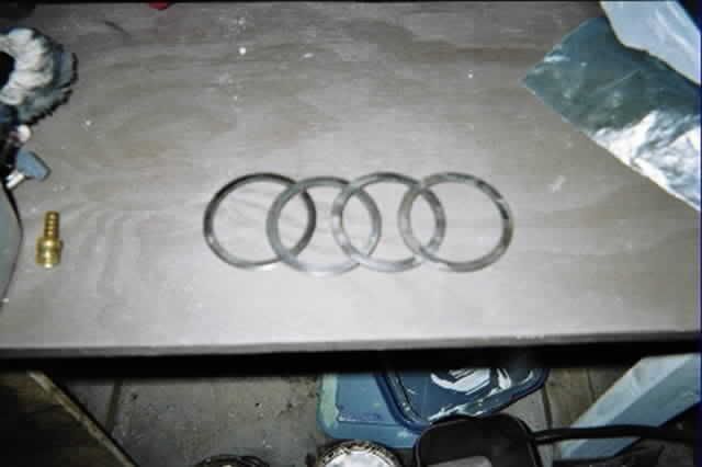

Once they are out, remove the caps, but mark them so you will remember which side they belong to. Also, when pulling the center section out, there is a shim on each side. KEEP THESE!!!! You will need these and may need an assortment of them to get it adjusted right after assembly. Most 4x4 shops can get you a shim pack for a decent price.

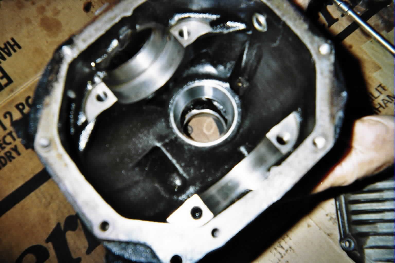

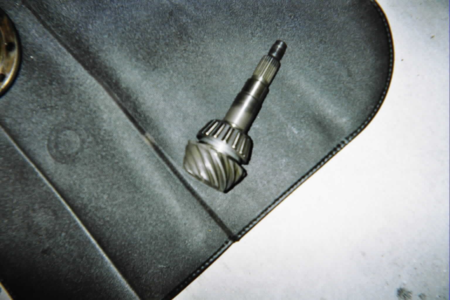

Now that the carrier is out, remove the pinion bearing. Remember how everything went together! Take pictures if possible. The outer pinion bearing will slide out from the nose. Now, if replacing the inner pinion bearing, you will want to use a punch and a hammer from the front of the diff and drive the race for the pinion bearing out. If replacing the outer pinion bearing, you will use a punch to push the race out from inside the case.

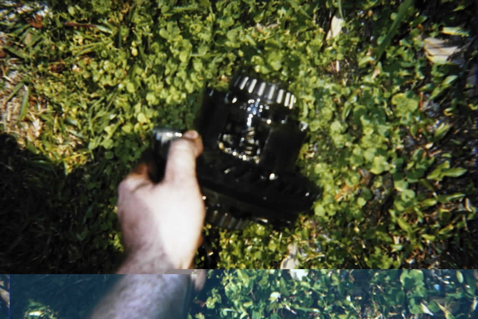

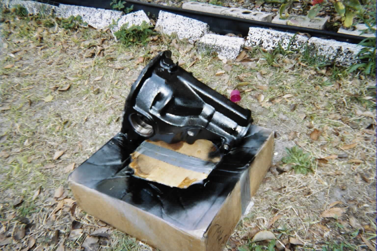

Next, the differential case needs to be cleaned. You can have it hot tanked at a machine shop, or, do what I did. I put it in a 5 gallon bucket and then poured purple stuff engine degreaser in till it was completely submerged. i let it sit for over an hour then scrubbed it with a stiff bristled brush. there is a black coating on the inside of the diff that will probably not come off. Do not worry about this. After I took it out of the bucket, I then scrubbed it with soap and water to get the degreaser residue off, and to prep it for paint. then i put the ring and pinion gears in to let them soak as well. When painting, make sure to block all the holes for the bolts and also make sure no paint will get inside the diff case.

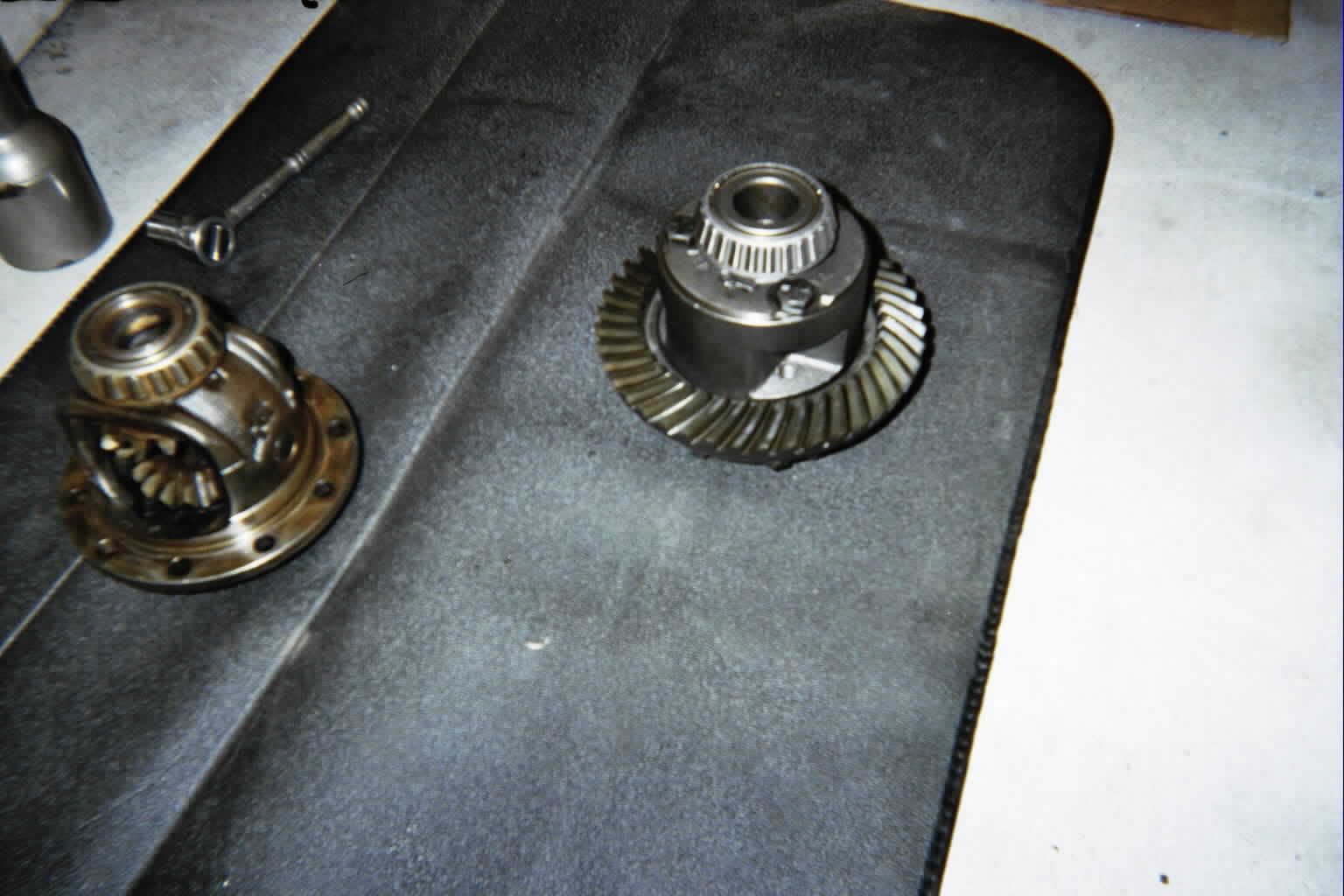

Now, if you do not have a shop press, you will need to take the True Trac and the carrier bearings to a machine shop to have them pressed onto it. Also take the pinion gear with you to have the old bearing pressed off and the new one on if replacing it. Make sure the shim is left on the pinion gear when they press the new bearing on if these gears came out of the case you are using and you are not changing them. If you are changing gears, you will need a pinion depth shim kit, which can be purchased at most 4x4 shops for Toyota 7.5in differentials. Setting the pinion depth is critical! Once all that is done your almost ready to assemble.
Dave soaked all the bolts and whatnot in carburetor parts cleaner for several minuets to remove all the gunk that was on them. I have found that a sonic cleaner with HOT water and a little bit of Purple Power, or dawn will work as well. Next, you will need a seal/race install kit(Brass punch in a pinch) to drive the new pinion bearing race/s into the diff case. Make sure you do this carefully as it must be perfectly straight, and you do not want to damage the surface that the bearing contacts. .

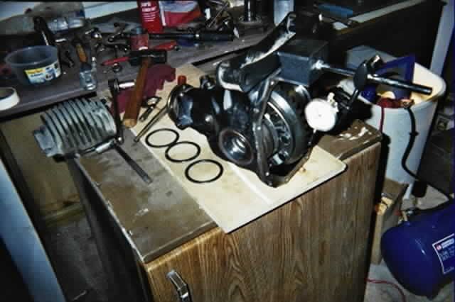

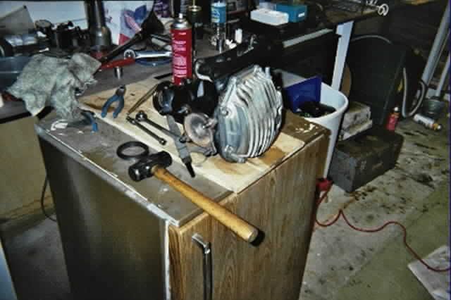

Once they are in, slide the pinion gear in, then put the new pinion seal in and make sure you slide the parts back onto the pinion shaft in the correct order(remember the pics I said to take?), and make sure you put the new crush sleeve/solid pinion spacer in there and not the old one. Be sure to use the new nut use a new nut. If using a solid pinion spacer, you should be able to measure the length of the OLD crush sleeve to get a starting point for the shims that come with it. You likely will need to add a small amount on top of this thickness to account for wear and tear on the original crush sleeve. Adjust until the preload on the pinion bearings are correct.
Once together, you need to very very slowly tq the nut (if using crush sleeve) until it takes ~3.5-5.2inch lbs for a used bearing or 10.4-16.5inch/lbs for new bearings to turn the pinion gear. If you tq it too much you must pull the nut back off and get a new crush sleeve so be very careful. Too much preload on the pinion bearings will destroy them very quickly! If using the solid spacer setup, once the bolt is tq'ed, check the preload. If it is too low, add another shim. if it is too much, remove a shim. Repeat until it is correct!

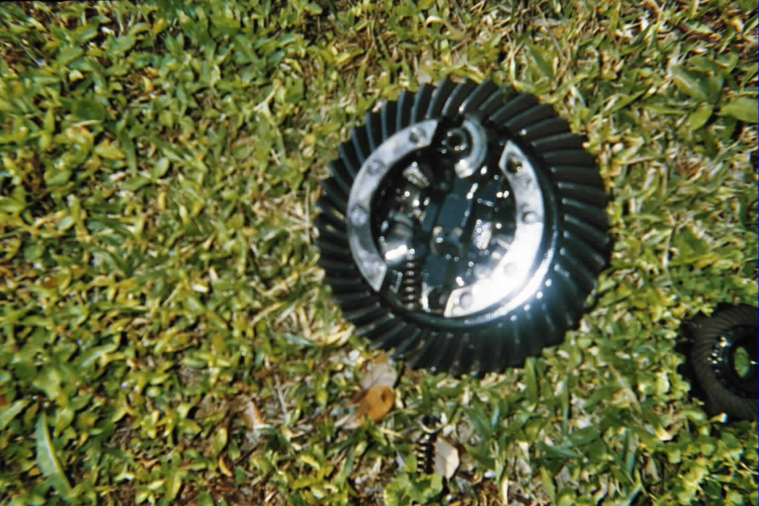

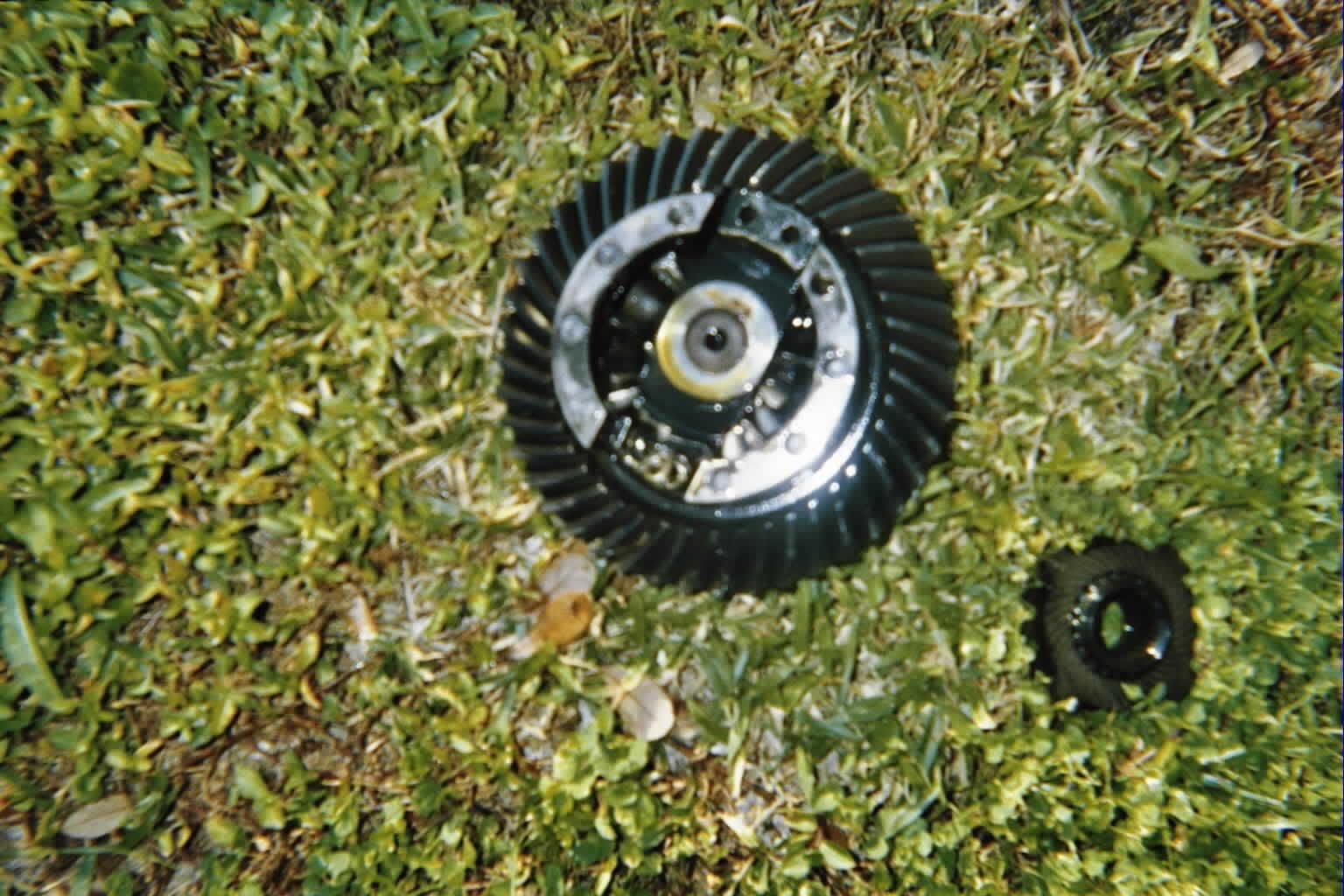

Next, you will have to use a small flat head screw driver and a punch to bend the little tabs back that lock the bolts that hold the ring gear to the center section. then use an impact gun to remove these bolts. Then you need to use new tabs when bolting the ring gear to the True Trac. The bolts need to be tq'ed to 71ft/lbs, then push the locking tabs up against the nuts as they were before.

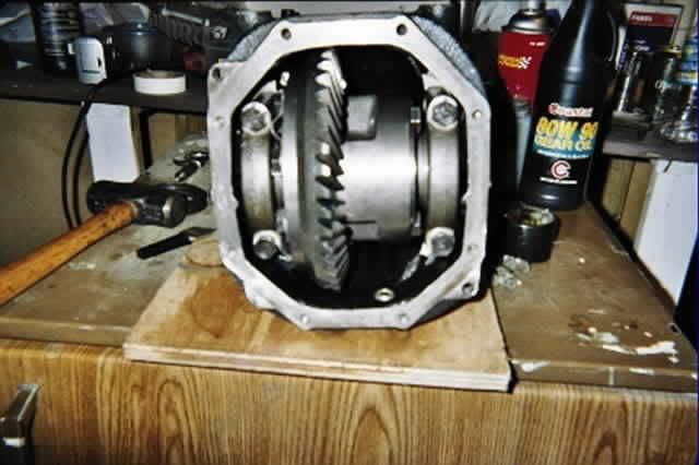

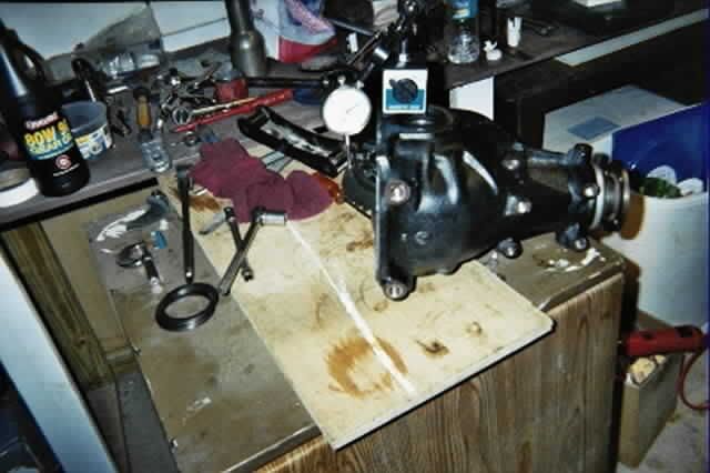

Next, insert the True Trac in with the races on each bearing and for starters use the shims you had removed before. The shims are used to adjust end play and the preload on the carrier bearings. The preload should be ~3.5-5.2inch lbs as should the total preload. The backlash should be 0.0051"-0.0071". You may need to install different thickness shims to ge the preload right, and adjust them to move the carrier from left to right or vice versa to make sure the "wipe" pattern is correct. Once the right end play and preload is set install the caps and tq them to 58ft/lbs and recheck that the preload and backlash are still within spec.
Use a new diff cover gasket and coat it lightly with ultra gray rtv sealant. It is best to rub a lil on your fingers and then smear it on the gasket so that there will be no excess to squish out. Then install the diff cover and tq the bolts to 16ft/lbs. Reinstall the axle stubs, and then fill the diff with the proper amount of fluid, and its ready to be installed.

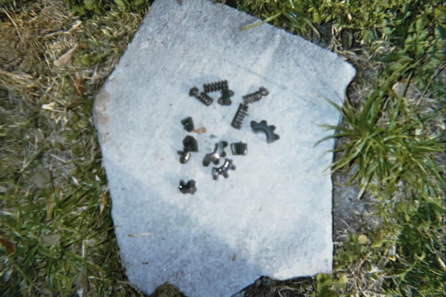

This is why I needed the True Trac.
