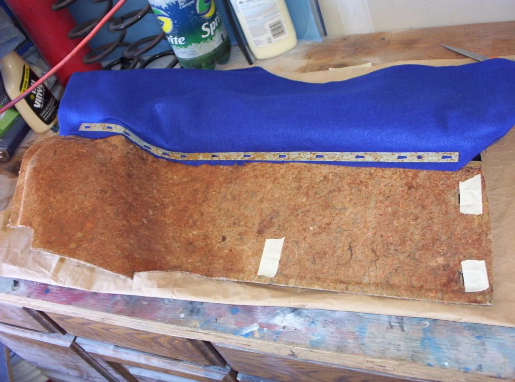

Now I can focus on my interior enviorment. I started with the rear armrest panels. This only took me a weekend, and I offer up this info in case anyone else feels the need to complicate their's as well.
The previous owner had glued on a piece of carpet to cover the tears.

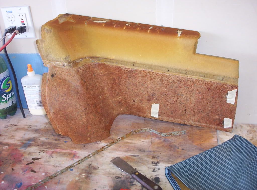

First, remove the panel
Remove all the staples holding the fabric and vinyl.
Remove the fabric and vinyl.
I used marine grade vinyl available from the local fabric store. 3M makes a decent spray glue, but Wilsonart does fine as well (Home Depot or Lowes).
Be sure to leave enough around the edges to wrap around to the other side.
I decided I wanted to go with black vinyl instead of the blue.
This was the trickiest for me. This bar had to have the fabric wrapped around it before it was glued down. I ended up laying it over the top, then folding it over where the bracket goes to avoid any wrinkles.
Once the excess is trimmed from the bracket, it is time for glue.
The edges get handled the same way the vinyl did.
Ended up with a nice product.

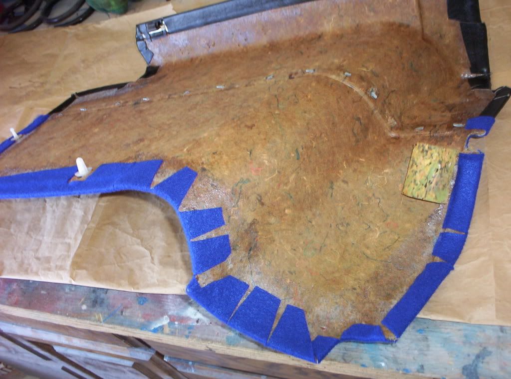

Cut out the vinyl to approximately the same dimensions as what was removed. Apply the glue and carefully lay it into place. Working slow at this point is crucial.
Turn panel over and spray more glue around the perimeter. While it is drying, take some time to make some cuts so that it can wrap around the curves.
This is where attention to detail pays off. Fold over the strips so that they do not overlap. This will allow good adhesion from the two mating glued surfaces.
Now we have a good fit.
