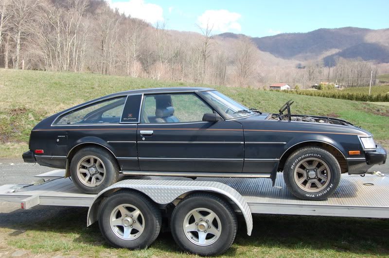

Ok, we have a ton of info. on the MKII. But, MK1 info is scattered out all over the place. The lug pattern for the 1979-1981 Supra is 4x114.3mm which is very common. Stock MK1 aluminum wheels are 14 x 5.5" and have a +27mm offset. This is very close to the aluminum wheel used on the L Type MKII. Remember the P Type MKII wheels are 0 - +10 mm (Info. from Chris Eng) in offset and will stick out more than many people like. So, let's get some pics of MK1's and what they are wearing.
1st pic.: XXR 16x7 +15mm offset, 215/55/16 tires
2nd pic: Enkie 14" 92's W/215-60 tires (+20 mm offset from my 20 year old memory)
3rd pic: MKII P-Type wheels. BF 225/60 tires (very similar spacing to the above 92's)
4th pic: I have seen these wheels on 3 MK1's now all with the same color/decal combo. They appear to be the same specs as the normal aluminum MK1 wheels.

These pics arent the best but give an idea.
My black PP w/ '85 15" L-model rims and 205-50-15 tires;
My 2-tone PP w/ 16" Konigs (16x7 +20mm offset) and 225-50-16 tires;

Here are mine. I think they are knock off AR`s. 215-60`s

Here is a sample of MkI photos I've picked up over the years - don't know wheel details on many of them. I've put notes by a few of them.
MkII 14" L-type wheels (82-84)
MkII 15" L-type wheels (85)
Enkei 92s (14x?)
15" Cressida rims
The Toyota MkI Pace Car (14x7s with 225 rubber if memory serves)

1978 Celica with 14" L-Type with 225/60/14's all the way around very minor rubbing on rear inner fender due to sacked out springs.

you guys made a couple mistakes, most of the pics that you guys wrote "l-type wheels" are actually "p-type wheels"
like this one, and there is another too
3rd pic: MKII L-Type wheels. BF 225/60 tires (very similar spacing to the above 92's)
are "p-types" :salute:
