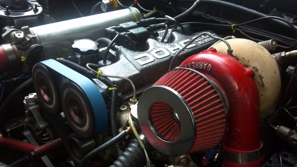

My buddy CJ has had many rape machines in the past collecting parts through out all of them, 78' 280z turbo, 96' Eclipse turbo, 70' 240z, & now an 85' RX7. He wanted to do something different so A mixed breed baby of a car was born through lot's of money, well over a 1,000 hours of fabbing, fitting, rebuilding, tuning & bitching lol. This is an 85' RX7 with a 70' 240z dash & console swap, First ever RWD 420a mated to an R154 trans. We've both had our hopes & expectations but some doubt's at the same time. And we were both very impressed at this past drift event Drift Valley III ( Facebook it ), The car ran flawlessly making awesome power as you will see in the video this is driveway tuning at it's best.[video]http://s1148.photobucket.com/albums/o578/nzty420a/?action=view&current=VID_20120926_181705.mp4[/video]

They are, And including that you can go full forged internals for about 1,000 & make well over 500hp is pretty impressive as well. Right now were just milking it waiting for something to happen, Cause as soon as this motor goes he's replacing it with a 2.4 bottom end. But the way it's running it doesn't look like it's going any where soon :thumbsup:

Darn cool man. Why 420a not 4g63, maybe had a built 420a from previous eclipse? I'm
digging the dash swap, and the nerve to do this project. Good job and thanks for doing something
different, seriously. Any plans to mash out the details, for look and i.c.e.?

Yeah dude 100% it's the first true 420a RWD ( there's a RWD drag car with a 420a in it but it's no where near an actual 420 it's custom block the whole nine yards this is a real one from an econo shit box everyday eclipse lol not custom everything made to similar spec ), 4G63 is completely different. There's plenty of those now they even have there own site dedicated to the swap ( that zero G site ). There's been a few try it in the past on 2GNT but have failed, And these new pics will clearly show that not only does it run & do massive burnouts but it is a fully functioning drift car with a very successful first event. I also added some more pics to the original post enjoy this was history in the making.
By the way that BMW in the top left corner had a 1J swap it's to bad I didn't get any pics of that
Not bad for the first track day & Him having less than a few hours of drifting experience, I see lots of good slides in the near future. Next month is a practice day at summit point, Today we made camber plates that turned out awesome we both cannot wait to see how much of a difference it made.

No need to be a smart ass he spoke the truth plain & simple, And people should have enough respect to post decently. We both don't want a bitching match to break out about how good a 4G is. We both know there amazing engines for there size. And the reason this was done was for way more than saying he's the first to do so that's just a great bonus. 1: The engine was already boosted running smooth why shit can it? 2: Like you said yourself there a dime a dozen if you blow it up so what we'll go tomorrow & pull another. 3: If you do research on this motor you'll know that the head is one very tough & two that the head is completely interchangeable with the 2.4 which I can find multiple cars pushing 400+ HP with just fuel & boost turned up on a 2.4. 4: A 2.4 can be had for dirt cheap as well & SRT-4 internals are compatible there's people making over 500 hp. The original game plan was to just do this set-up & swap in a 2.4 when it blows, but the more research we did shows that the 420a is a more than capable engine. A 420a is stud girdled from the factory & people are making 400+hp with forged internals with a stock crank & stock head. You can get forged rods & pistons for under $900 that's cheap, but before you go forged you can simply get a 2.4 block & swap in SRT-4 internals & make 500hp for cheaper to equal prices. Either way you look at it that's impressive & that kind of power in a barely over 2,000LBS chassis is insane.
