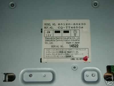

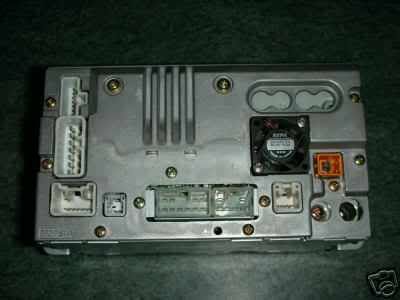

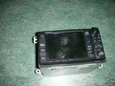

Hi,
I've seen this Matsushita, and the rear plugs seems to be the same as our cars.
Have anyone tested something like that.
The seller says :
"TOYOTA SAT/NAV TV CD RADIO CASSETTE
MODEL 56009
THIS IS FOR THE SALE OF A FULLY INTERGRATED TV SAT/NAV SYSTEM
THE SYSTEM IS FROM A TOYOTA LANDCRUSIER IMPORT SO THE LANGUAGE IS IN JAPANESSE AND THE RADIO BANDING IS DIFFERENT CAN BE CONVERTED 2 ENGLISH BUT ITS FINDING SOME 1 WHO CAN DO THIS AS IT WONT BE CHEAP I DONT HAVE NO PLUGS 2 THIS UNIT WANT SO EVER AMFRAID THE SCREEN IS A BIT HAZY BUT WHEN POWERED UP U CAN NOT SEE THE MARKS PLEASE NOTE IF U REQUIRE POSTAGE GIVE ME UR LOCATION AND AL GET A PRICE FOR POSTAGE BEFORE THE AUCTION ENDS AM SETTING THIS AT A LOW PRICE NO RESERVE HAPPY BIDDING"
if i buy it , can i connect my PYLE TV tuner, or a car DVD player and have signal there?
#2 ·
I would watch out, Some of these had a seperate nav box in the back of the car. Looks like a cd changer it holds the nav discs and computer. The radios usualy wont power without it and also if it the radio came in a JBL equipped car ther is no amplifier in the head unit. There is no video input on the unit so I would say you cant use it without major modification.
#3 ·
Can the seller also get physical dimensions for you??? Not everything always fits well in our radio openings.
#4 ·
I can tell you on an 85 it will go in and hit part of the AC behind the stereo all the way in the bake. Its a gold cover with part of the AC mechanism behind it. You will be about 3/8 of an inch front the mounting bracket bolting into the holes and the face plate will stick out about the same amount from the radio surround.
Jake
